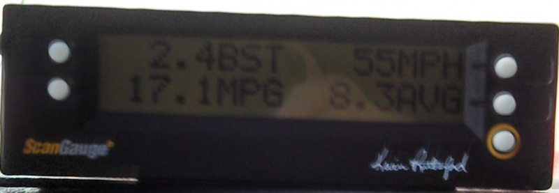

    I should have bought one of these a long time ago and will get one for my son's truck soon. Still need to get some use in under a heavy load, as this week so far has been light stuff. This is the gauge on an easy stretch, I-71 starting at the J in Jeffersonville exit 69 and the picture was taken somewhere in Cincy, so about 60 or so miles on pretty flat terrain, no wind. Light load, total truck weight at about 45k. The running average here is actually a little low. It had gotten as high as 8.9 and been staying right around 8.5 most of the trip. A couple of hills coming into Cincy pulled it down a few 10ths.

    I know running heavier will take away some of that gain. I'm expecting to see 0.4 - 0.5 improvement despite that. The main benefit is coming from just a tiny adjustment that I can now manage with the numbers right there on the dash to see. If my boost pressure is <10 psi I'm getting 7+ mpg. Go up to 12 and it's dropped to 6. 13 and I'm in the 5's. More than that, mpg just sucks. Thing is, with road noise, music, and my not so crisp anymore hearing, pulling on 8 psi boost vs. 12 psi hardly sounds or feels different. But it's clear as day watching the numbers. This purchase will pay for itself this week.

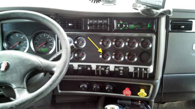

    Spyder covered it pretty good. My boost gauge is located low and right, in a cluster of other gauges. Ok to glance at now and then, but too far out of sight to watch closely. The SG is on the left end of my dash, up top just off my line of sight. Easy to monitor while making tiny changes to throttle input.

    Even further this morning. Norcross, GA to the south side of Macon. Local traffic both ends plus the tail of ATL rush hour. On the plus side, about a 700' drop in elevation so more downhill than up. Solid 6.8 mpg for today when I parked, trip average unchanged at 6.9. Same load on board and not maxed out, but enough to see how much drag it adds.
    This is what I'm talking about with the factory gauge. During the daytime it's in the shadow of the dash and hard to read other than a rough idea by the needle. Easier at night with not so much outside light and the gauge back lit.
