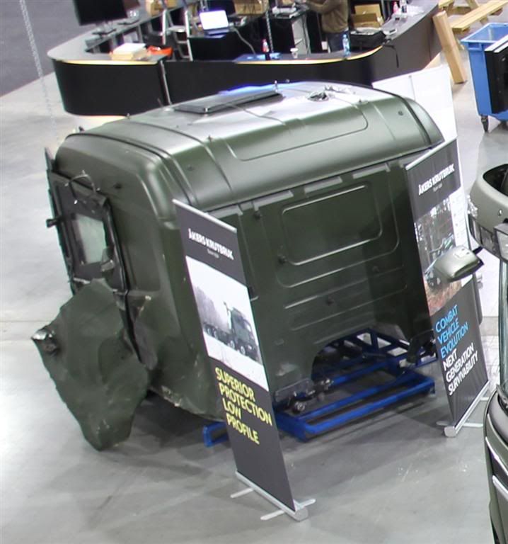

as for the protection scania mainly use http://www.akerskrutbruk.se shield
i have seen only french army use different shield
![[IMG]](proxy.php?image=http%3A%2F%2Fi166.photobucket.com%2Falbums%2Fu87%2Fbarun98989%2Fupload%2520novo%2FUntitled-1Large.jpg&hash=72d38127c84f16ff429831201b7eaefb)
![[IMG]](proxy.php?image=http%3A%2F%2Fwww.akerskrutbruk.se%2Fwebsite1%2F1.0.1.0%2F60%2Fimages%2F%2F199_4a84f664eafec8205faa9223a4ace092.jpg&hash=fa4896c8f497b1b4c259103799982be7)
![[IMG]](proxy.php?image=http%3A%2F%2Fwww.defence-update.net%2Fwordpress%2Fwp-content%2Fuploads%2F2010%2F09%2Fadd_on_v_hull_scania.jpg&hash=117e3c0af89f9030c641ab6e6079b568)
