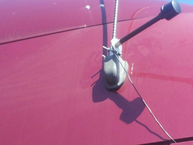

    Can u do it this way on your truck

    Ah, I suppose I could! That IS perhaps the only metal I could use! The taping of it on my Sirius' window mount has worked just fine, fortunately. Just the wee little antenna that comes with the units, too.

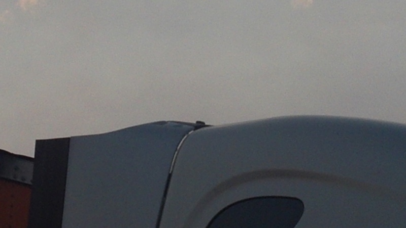

    I tried using one of the small square ones I bought on the passenger mirror but found that I lost my signal anytime I was heading Northwest. I figured somethign similar would llikely happen if I tried to attached the old truck style antenna I had from my century to the factory antenna. I also didn't want to mess up my CB/TV signal any more than it already is with the crappy factory antennas.
    Here's how I mounted it instead. This took me about 20 minutes to get the way I wanted while sitting in the Iowa80 TS Parking lot. I was able to just climb up the wing supports. Keep in mind I'm pretty small at 130lbs so some of the heavier guys might want to use a ladder to get up there.
    Visible in this pic:
    The cord for it then runs down through the wing supports to where the two pieces meet. The cord is attached to them with zipties.

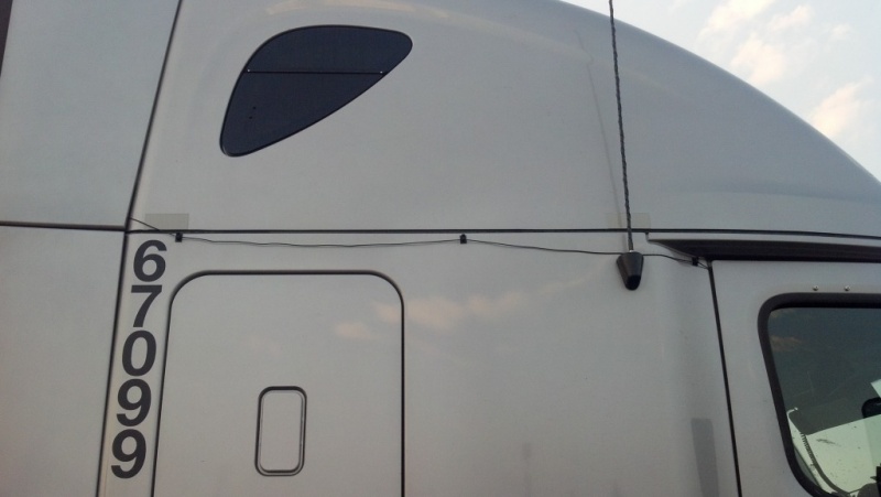

    You can see where the cord comes over the plastic and down through the supports:
    It then passes between the cab and wing and through 3 small plastic cord holds that are held on with some double sided tape. These can be purchased at any truck stop for like $3 for a pack of 4.
    Pic:

    You can't see it but I bought the oil magnet one with the double sided 3m tape and mounted it there before I found a spot for the original antenna
