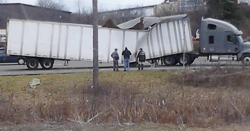

    mickeyrat Road Train Member
    7,859
    7,542
    Nov 24, 2011
    on my 30 min break
    really glad I'm not him
  11. mickeyrat
    7,859
    7,542
    Nov 24, 2011
    on my 30 min break
    Oh yeah, kind thoughts for that driver of ours that jacked on the freeway I 96 in Mi. Poor guy must have hit a slick spot before the plows could salt yesterday morning. On top of that 4 wheelers have to relearn how to drive in weather. Dude wound up in the center median. Almost did a complete 180.
