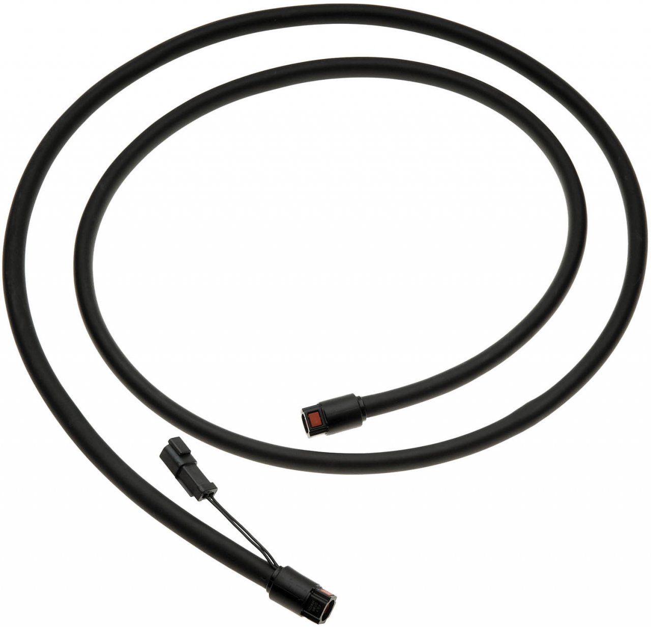

    Forgot to update you guys. It was the DEF hose. It runs from the DEF Tank to the Def Dozer. It was exprensive $325 at my local Kenworth dealer. Much cheaper online but I couldn't wait for it to come in the mail (it would result in more down time). So it was a pain in the *** to install. I found it easer to access to remove the driver side fairings (easier to get under the truck), and then there's a black panel behind/under the DEF tank where you attach the other end of this hose. You have to remove the bolts off of that to access where it attach/detaches.
