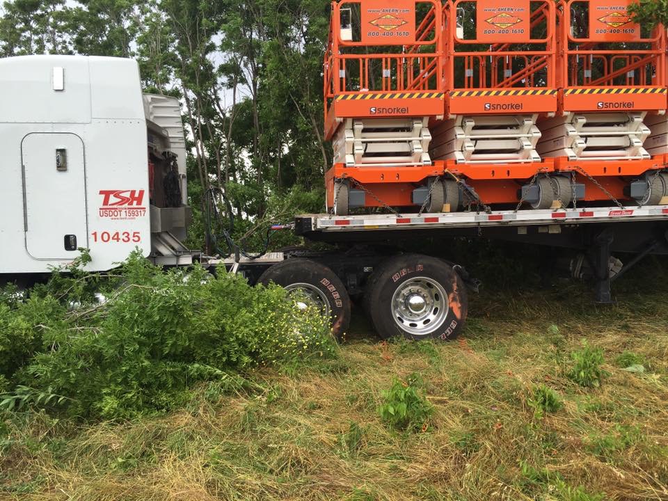

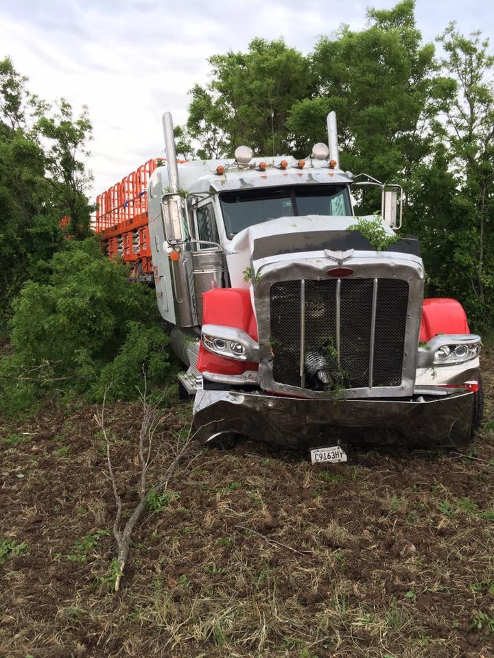

    Next time secure them like this. A guy posted this on Facebook drove off into the woods and it looks like they didn't move an inch.

    Interesting.
    Those look a bit larger than the ones I had. Mine went from nail board to nail board,.. maybe 6ft in width. But I could easily do them that way.
    Thank you.

    That poor Pete.

    Hurst, i would look at this, if I were you. You say that if anything broke or came loose only two machines would come loose, I would suggest that if something broke, you would have that entire side (contained by that chain) come loose, to some degree. You do have the chain binders, but the way they are hooked, if the chain to one side came loose, the angle of the chain binder would change, which lets the chain on the other side of the binder come loose. Make sense?
    The other thing that I would question, depending on how picky an inspector would like to be, is aren't you required to secure moving parts like buckets? Wouldn't that mean securing the platform part in this case? I haven't hauled a lot of those but I've never had one that pinned in place, which means that it should be tied down. To me that means a strap over the top of each individual lift, even if it's not tightened down enough to be considered a a proper tie down for the whole unit.
