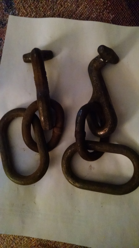

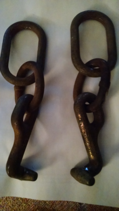

    This is the tie down equipment I use for vehicles. They fit into the oval cutouts in the frames in all trucks and cars. Even some type equipment have the oval cutouts for these tie downs. Works great just put them in the ovals turn them 45-90 degrees and they won't dislodge. The body of vehicle doesn't bounce while transporting.
    MJ1657 and BROKENSPROKET Thank this.

    I have to concur, the only and best way to secure light and Med duty trucks are thru th use of frame hooks. if done right the truck just lays there doesn't come loose no bounce and rides nice. Tire straps work well but don like using then above 1/2ton trucks.

    I am going to get me some of those. Those can go where the grab hook won't.
