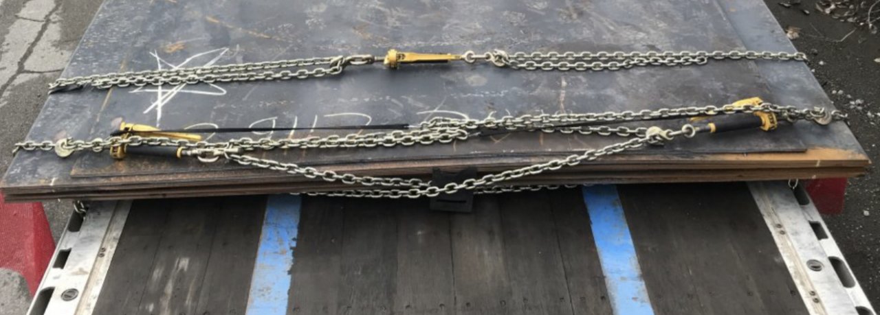

    Looks like it’s hooked to one side of the trailer then over the plate and back under to the other side to me.

    14,422

    Not exactly...

    @Pedigreed Bulldog there are 5 chains going across the top of the load and 2 “X” chains on each end. I used 20’ chains for each half of the “X” but I used shorter chains for the ones going straight over the top. The first four are an 8’ chain on each side of the trailer, connected in the middle with a binder. The last one is the same way but with 12’ chains. Nothing going underneath the load except the corners where the “X’s” hook.
    @kylefitzy is right, the double chain you see is actually just the excess held in place with a bungee. I know the short excess won’t cause any harm since it can’t reach over the edge of the trailer, I just held them in place with bungees because I think it looks nicer.

    For what it’s worth, I carry eight 8’ chains, eight 12’ chains, and six 20’ chains. I’ve found that I rarely need a 20’ chain, so I cut some of them down so they’re easier to work with securing machinery and things like that.
    I was told that it’s perfectly acceptable to connect two short chains with a binder in the middle. If this is incorrect I’ll use my G70 quick links to reconnect them into 20’ chains before I roll tomorrow.

    This does bring up a good point though about the way people perceive load securement. As I said before, I did it this way because I think it looks nicer than having loose chain ends hanging freely. Nice, neat load make the scale master happy, right? Did I actually invite closer scrutiny at a scalehouse though because there could be some confusion as to whether those are loose ends or doubled up chains?

    There’s nothing wrong with doubled up chains.

    Makes sense to do it that way with shorter chains. I missed the bungees, 'til it was pointed out and I zoomed in on them.
  11. jamespmack
    19,977
    215,621
    Two short chains are fine. Just as One long chain can be two as long as there is slack between binders. Say you throw a chain thru a suicide coil. Bind it down, now take excess chain and throw it back thru and hook it. Then attach binder to tie down and that section of chain. As long as there is slack between first tie down and Second binder you have just completed two securment points with one chain.
