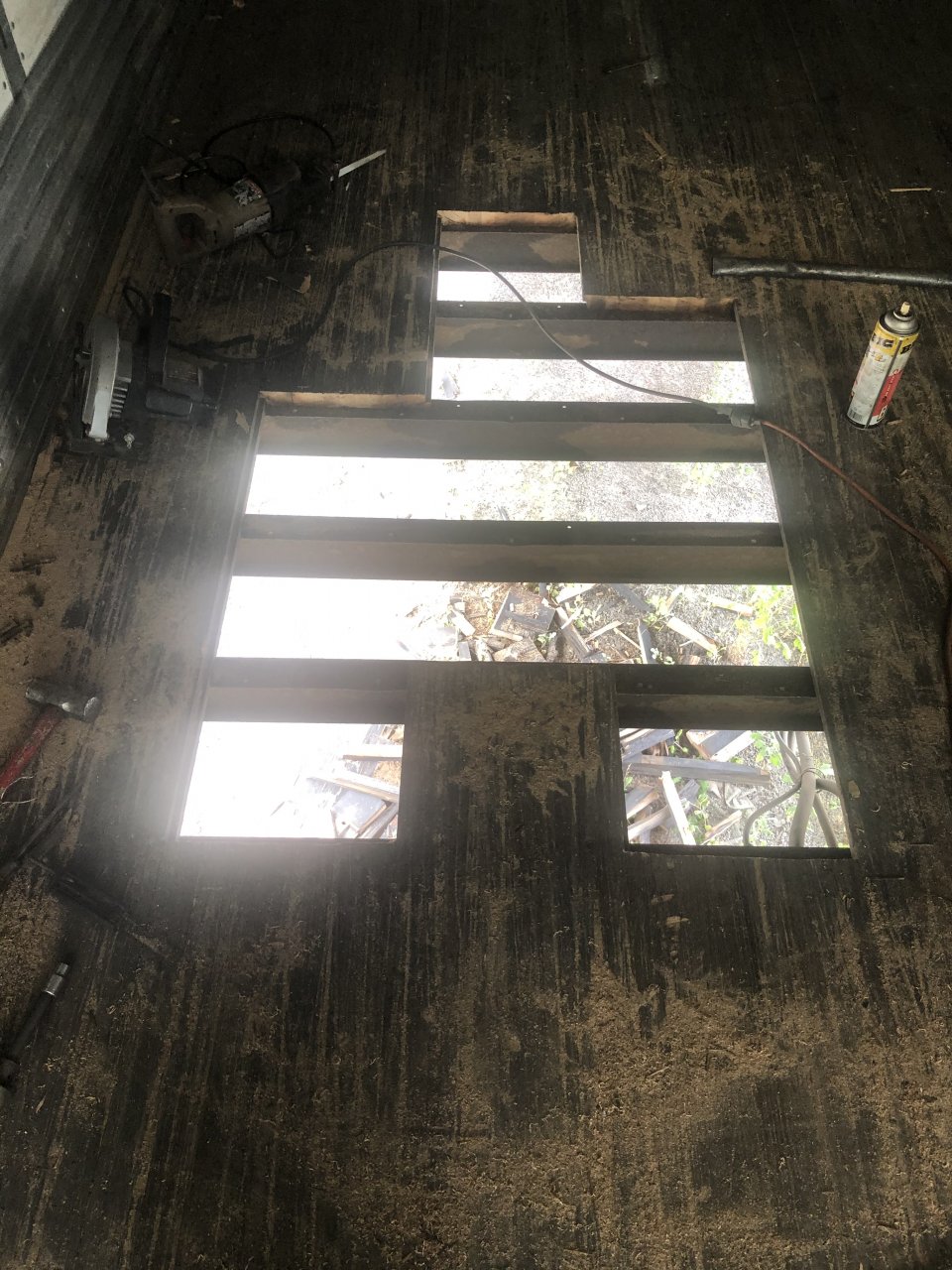

    I cut the old flooring out, using a skill saw, and a sawzall. Once it’s cut in the right places, alongside of the screws, along the T&G, about 1/2” away, then cut it through between the cross members. Then I hit the wood with a hammer, from inside, knocking it onto the ground, leaving the screws in place. Dig the T&G’s out with a screwdriver. Then, most of the screws came out, using torx bit on 1/2” drive ratchet. Vice grips on a few. A few snapped off flush. Easily removed from the bottom with vice grips, then reused the holes. Only had to drill crossmembers at the ends, where boards butt together.The cross members were easier to drill than I expected. They’re thin and flimsy. Be sure to lay boards so tounge and groove line up.

    Those pictures make my knees hurt

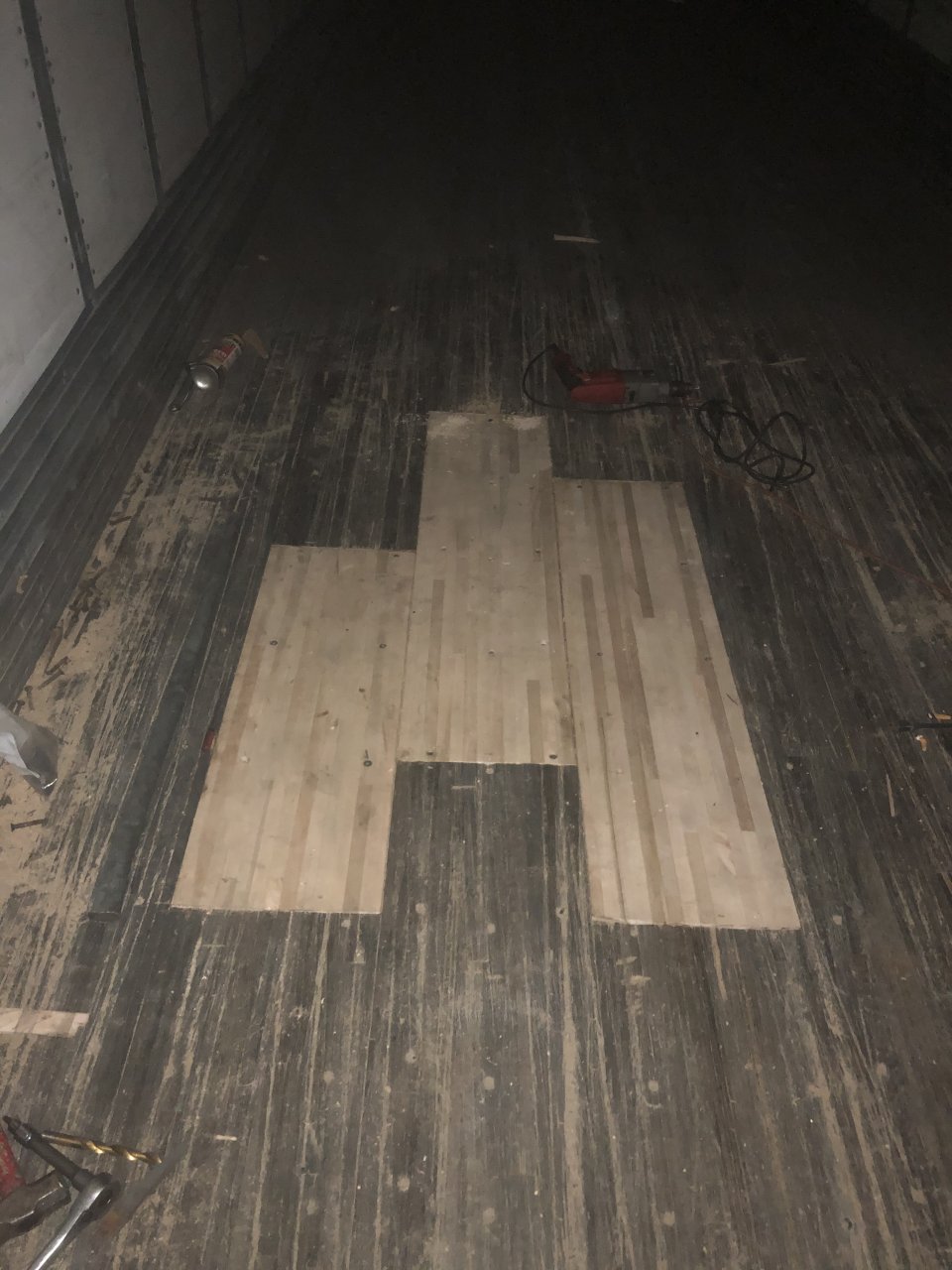

    Another thing that @Rideandrepair photos reminds me. Never line up 2 cut seams in a repair. It will create a weak point. Filling the seams with wood glue helps too.

    I should have cut the piece nearest the wall longer. At least 1 more crossbeam towards the rear of trailer. I accidentally cut one too short. Had to improvise. There’s a visible dip in the floor now. Cross members look good. I think my new wood is 1/4” thinner maybe. I should redo the job. I’d rather just send it to auction.
