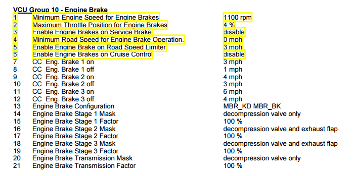

    there are 21 different settings in the ECM which change that.

    And do any of these affect the strength of the brake? No they do not. Those setttings affect when the jake comes on, not how strong it is.
