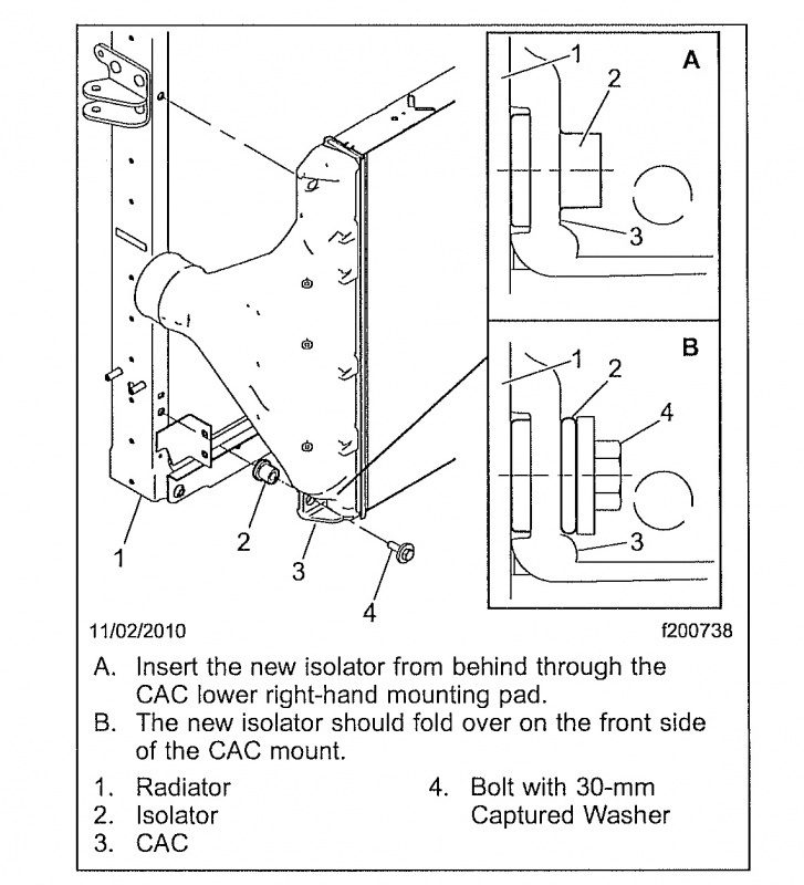

    I have attached a updated bolt kit for the cac mounting. i believe this campaign had something to do radiators leaking. but i am not 100% sure. you may not even have this style radiator.

    Looks to me that they have added a better cushion against vibration (section B) with the update.
