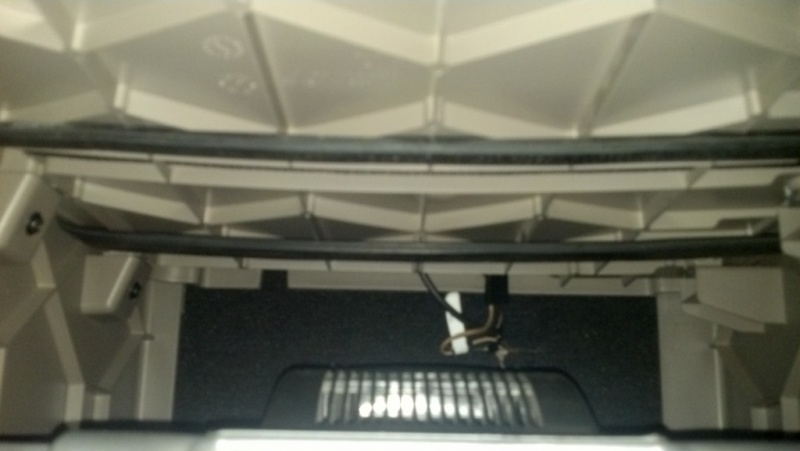

    I use a 24" Sansui LED TV that I picked up from Walmart for just under $200 on sale. Only weighs 9LBs and draws 34W of power. I can run both the TV and my Xbox off the same 300W inverter.
    As for mounting, I'm in a company truck so no drilling holes in stuff. Instead I made a base to use a swiveling wall mount. The mount is rated to hold 45LBs fully extended so 9LBs while folded up and bouncing down the road is nothing.
    Here's a pic of the base and wall mount after finishing them at home:
    Materials:
    4ft of 2x4 board
    6ft of 1x2 board
    12"x18" piece of Plywood
    Several 3" screws
    Several 1" screws
    2 Eyehooks
    1 Wall Mount
    To mount it I spent about an hour disassembling the cabinet to get the shelf out of my Cascadia. They are screwed in using 10 screws.
    Here's pics showing how it's mounted and the straps wrapped around the base and through the sides then under the shelf. Also shows my inverter plugged into the 12V port in there. I only turn this inverter on when I plan on using the TV/Xbox.

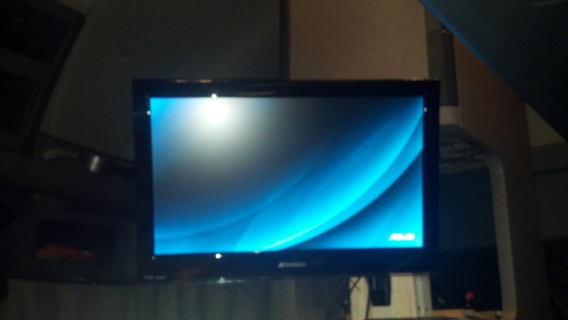

    Here's what it looks like from the back corner of the sleeper. I can turn/tilt any way I want.
    This is from the drivers seat. I prefer to do this when playing CoD because it's slightly more comfortable than laying in bed.
    Here's what it looks like when stored and driving. The towel keeps the screen clean from dust and protects the back of the TV from rubbing on the cabinet behind it when hitting bumps.
    Bungie wraps around the back and hooks to the two eyehooks on the top of the mount.
    The mount is held together with just the screws. It's plenty solid to hold the 15lbs of TV and mount hanging off the front of it.
