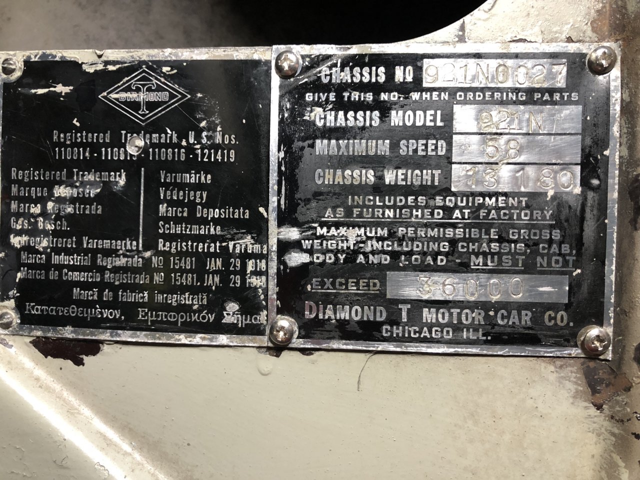

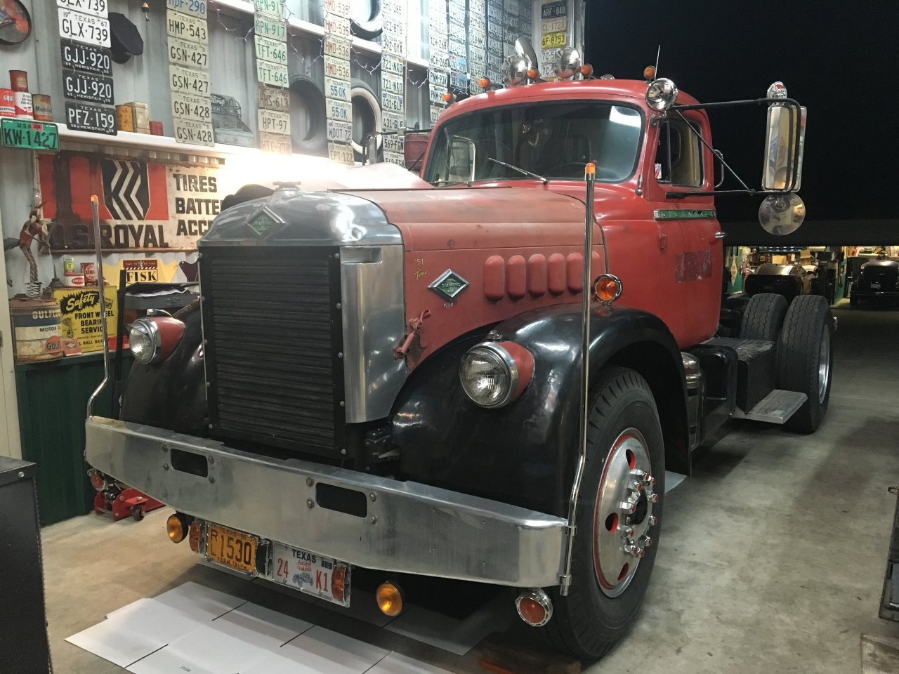

    Fuel pump Governors work exactly like @woreout and @Oxbow say. The Cummins PT pump governor was arguably the most simpliest and easiest to “hotrod” of them all.
    That being said you can govern speed by both engine rpms through the fuel pump and overall gear ratios to the rear wheels. Due to extrememly low gears My ‘51 Diamond T is governed at 58 mph at stock set 2100 engine rpm yet the engine can still run at its “hotrodded” governed 2400 rpm. It is purely mechanical and the engine has plenty of steam just not enough leg. In that extra 300 rpm It will not go any faster due to being what is called “gear bound”. But technically I guess that could still be considered just a mechanical speed limiter.

    Pics of the diamond T ???

    This was a few years ago when we drug it out of the barn to start playing with it again. Laying down cardboard boxes and ready to polish the hood and aluminum bumper, radiator, and wheels.
