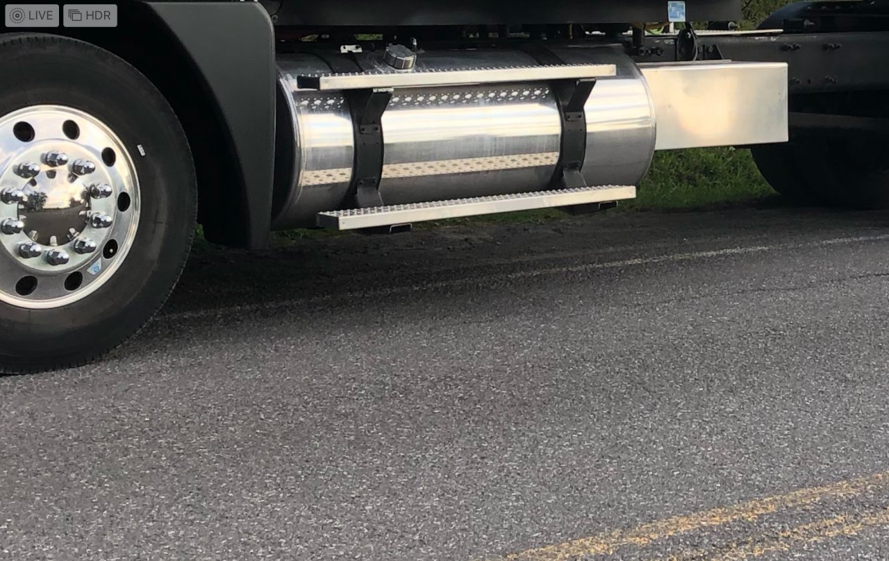

    Here’s how mine are on my 2007 Columbia
    100 gallon tanks
    bzinger and Rideandrepair Thank this.
