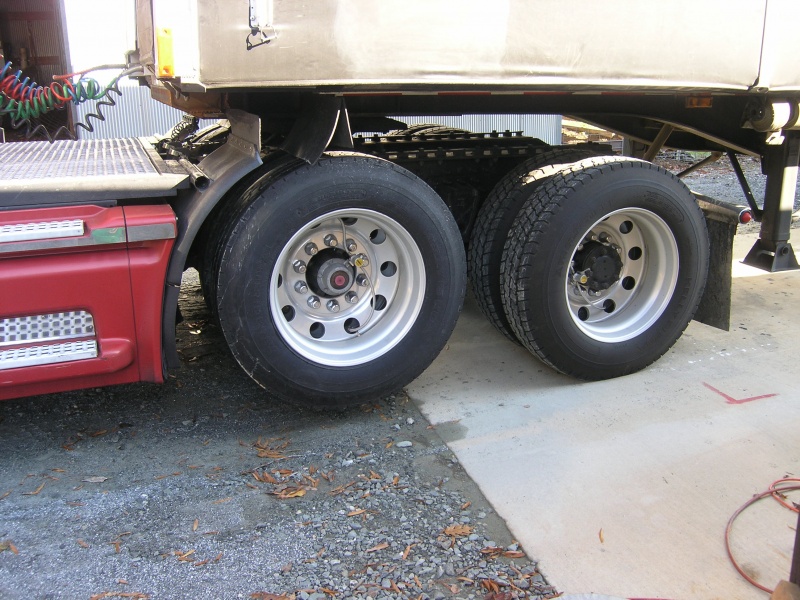

i put a drop center trailer axle on the front.
i lift it by:
1. dump air out of airbags

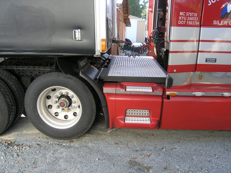

2. tighten up two 2 inch straps, see pic 3
3. close manual air valve , located at rear or truck, to close off air to front set of bags
4. open manual air dump valve to allow any extra air to escape
5. reinflate suspension from cab
6. rear axle picks up front and the two 2 inch straps hold it up.
5 minutes tops for both the trailer and truck and i'm going down the road on 3 axles.
