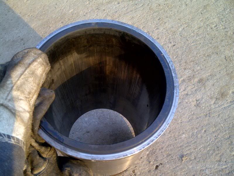

Outside of the liner looks good
Inside, not so much. Hard to see in the pic but theres little heat cracks in it like you'd see in a drum.

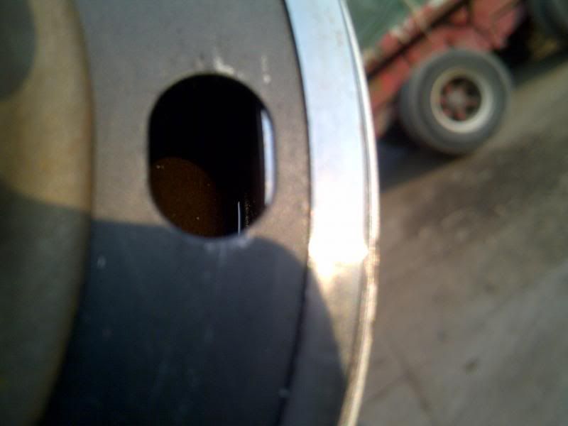

There is traces of oil in the oval shape of the piston
