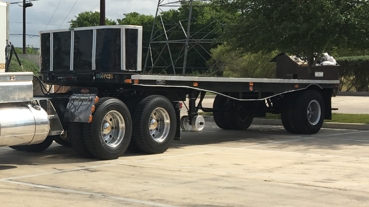

    I welded c-channel pads on the wheels years ago. Gives it a little more lift for tall rubber. It can’t roll easy and if it did it would not go any further then the pads rotating around and stopping when they hit the stalk.

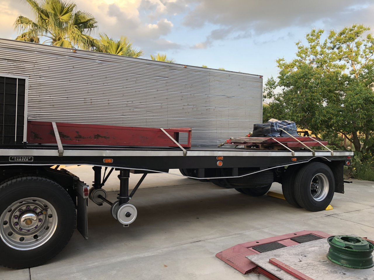

    I always kept a couple wood blocks for behind the tires, or almost back under, attach the service line, pull the Johhny bar, then back under.
