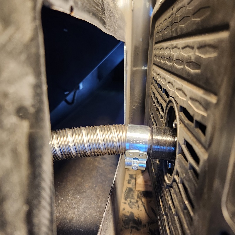

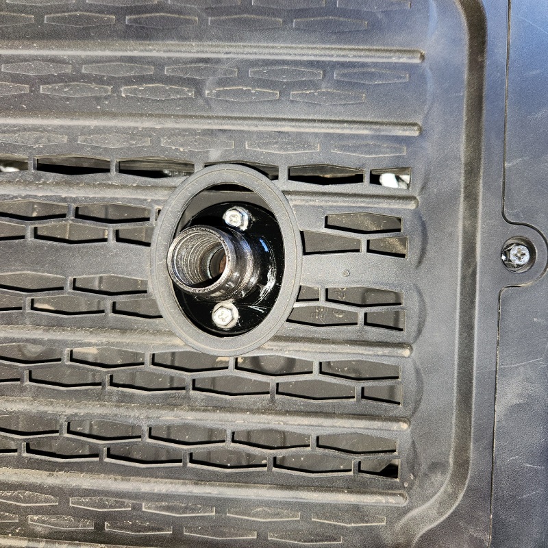

    I'm much luckier than most. I have my own cnc plasma cutter, and access to an engine lathe next door. I made this adaptor after removing the spark screen. Then I have a piece of that ss diesel bunk heater exhaust hose, and used it.
    Please disregard the crappy cut job on the box panel. It was about the third iteration.

    Nope.. if I turn it around so the control panel is forward the oil check door and pull start would be unacceptable as they would be inside the frame rails..
    Nice job on the exhaust
