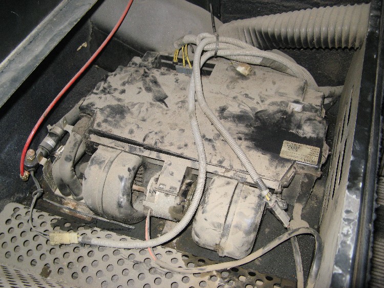

    I just bought a 1998 freightliner fld120 and under the mattress is what looks like some sore of heating unit. All it says on the top of the plastic cover is Behr Inc. So was wondering if anyone has something like this in their truck, and how is it suppose to work? It has some pipe running out the bottome of the sleeper up to the engine and has a couple blowers on it. I don't know if it works or not cause haven't been able to figure out what it exactly is.

    it could be a webasto unit too. is there a knob on the panel that says webasto? take pics.
    if it is your bunk heat and ac it will have two heater hoses going to it and two ac lines, a squirel cage type fan and ductwork going u to the ouput ducts. I'v never looked at a freightliner bunk hvac unit. there is seerate units for the cab and the bunk though

    Here is a picture of that unit I was talking about.

    That is the HVAC unit for the bunk, most of the trucks I have driven that had them worked. The heater usually works without problems unless the fan has quit. The AC unit might not work, AC requires fixing from time to time.
    The unit is always on the right side of the truck. The Rigmaster unit is usually put in the center compartment under the bunk, they run the refrigerant hoses up through the floor. Larger inverters are usually located under the bunk as well, they can be in either place and require heavy cables to the batteries to work.

    Does that unit run off the a/c pump on the motor or does it have its own? And does the truck have to be running for it to work?

    it's the same as the unit under the dash. yes the truck has to be running and usually it is a slave unit so the unit up front must be on for it to work, at least with the ac. It shares the same ac system as the front unit and the heater has hoses running to it from the motor. usually the hoses run from the motor to the front unit, out of the front unit back to the bunk unit, out of the bunk unit and back to the motor.

    That's just the standard heating/cooling unit for your bunk
