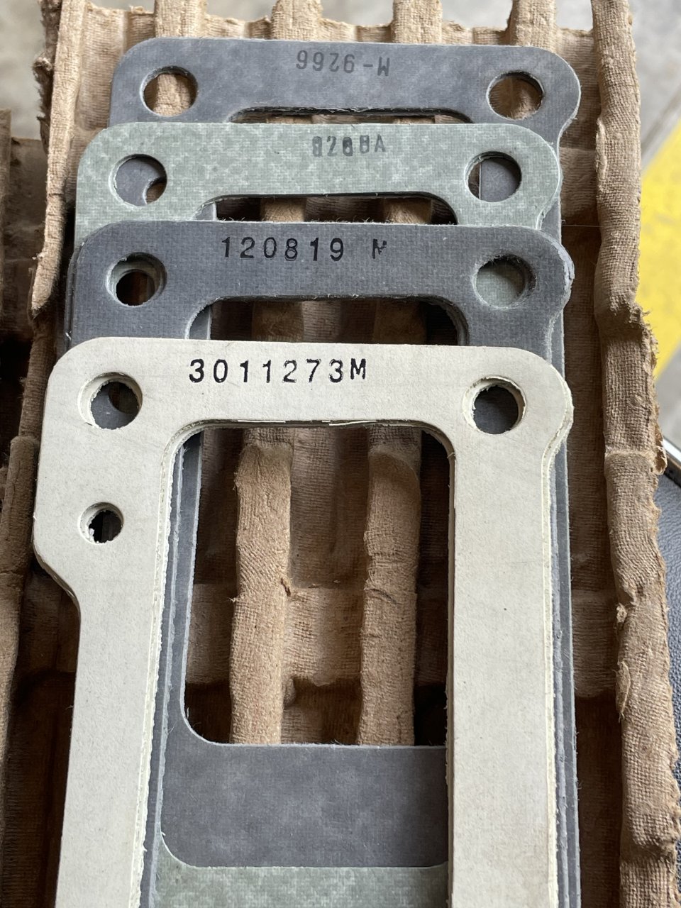

Small cam Cummins cam follower gaskets

  7. OLDSKOOLERnWV
    18,363
    276,485
    If you have any problems finding gaskets, pm me your address and I’ll give you some of these to help you out. Doubt I’ll ever have any use for them…
    mile marker 27 and pup Thank this.
  8. OLDSKOOLERnWV
    18,363
    276,485
    Sorry for the delay but they are in the mail…..
    Oxbow and mile marker 27 Thank this.
  9. OLDSKOOLERnWV
    18,363
    276,485
    3 of each thickness….
    Oxbow, mile marker 27 and pup Thank this.
  10. mile marker 27
    mile marker 27 Road Train Member
    1,230
    1,635
    Dec 4, 2019
    Got’em. Thank you, sir.

  11. OLDSKOOLERnWV
    18,363
    276,485
    You’re welcome, glad to see someone use them…
