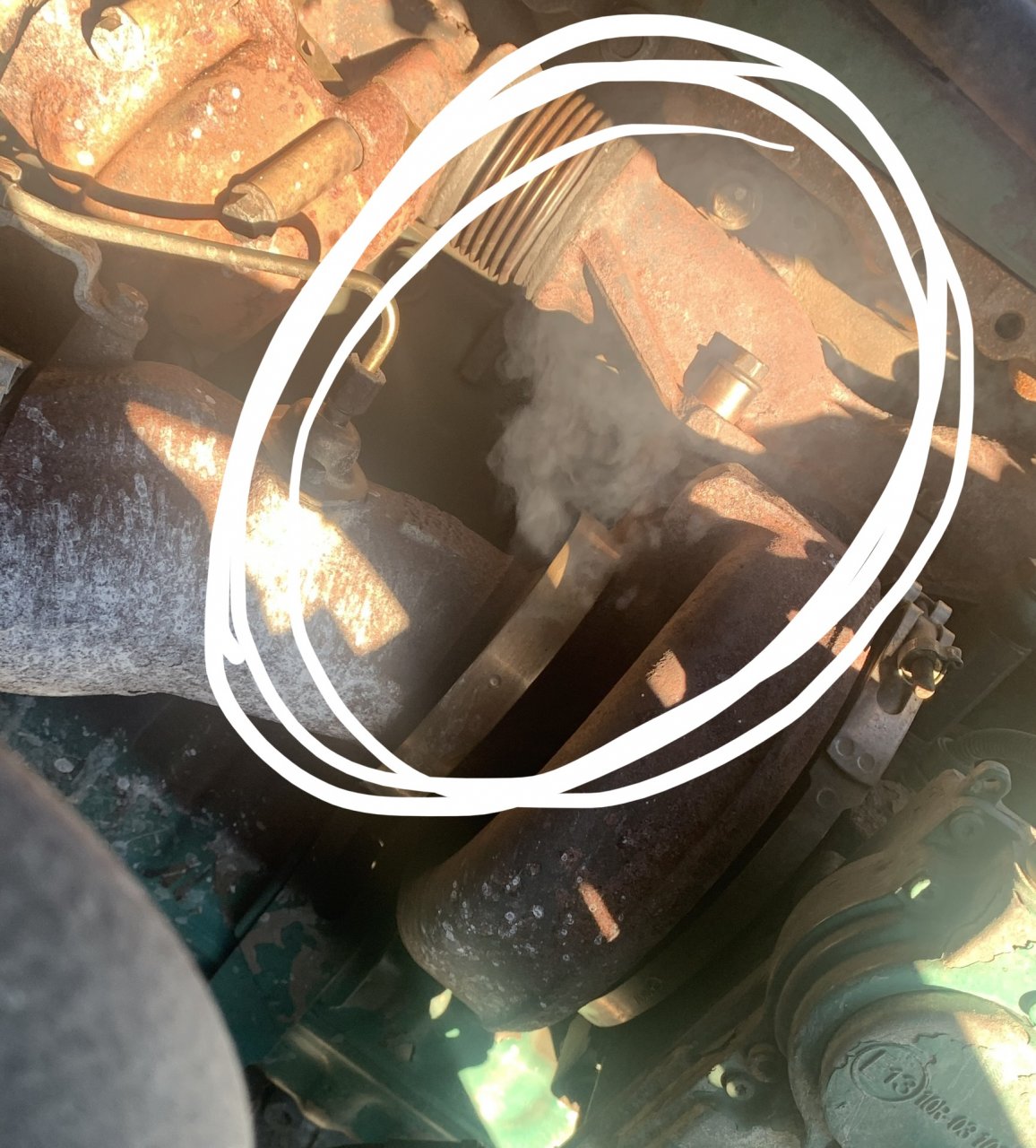

    i haven’t repaired the heater it just seems to be coming from the vents. It’s possible it’s the antifreeze. Just spent 45 mins taking off the dash on the passenger side and it’s not directly coming from anything on that side. Trying to take off center dash now…
    the smoke starts immediately after I turn the truck on

    I think I found it… I just have no idea what I’m looking at unfortunately

    Looks like that clamp is crooked on the turbo outlet. The section of exhaust pipe isn't properly seated..
    Or coolant could be dripping.? Looks like a water droplet of some kind on the clamp ring..
    D.Tibbitt and Okie Trucker Girl Thank this.

    Looks like the smoke is coming from the bolt hole where it bolts the outlet pipe to the turbo.

    Holy #### … I just touched the clamp and the whole thing is not connected

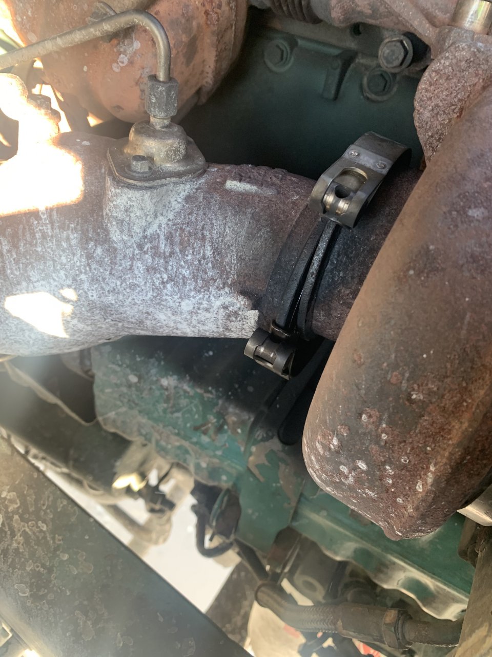

    Is the clamp broken, or just loose.?
    Guessing it is similar to the larger clamp in you're picture (to the right) to try verify if loose or broken..
    If you can't reach, gonna have to get the air filter out of the way so you can..

    the screw is missing from the clamp. I can reach it better if I stand on my step stool in front of the steer tire instead of to the side. I’ll give an update once I get a new clamp. Thank you!
