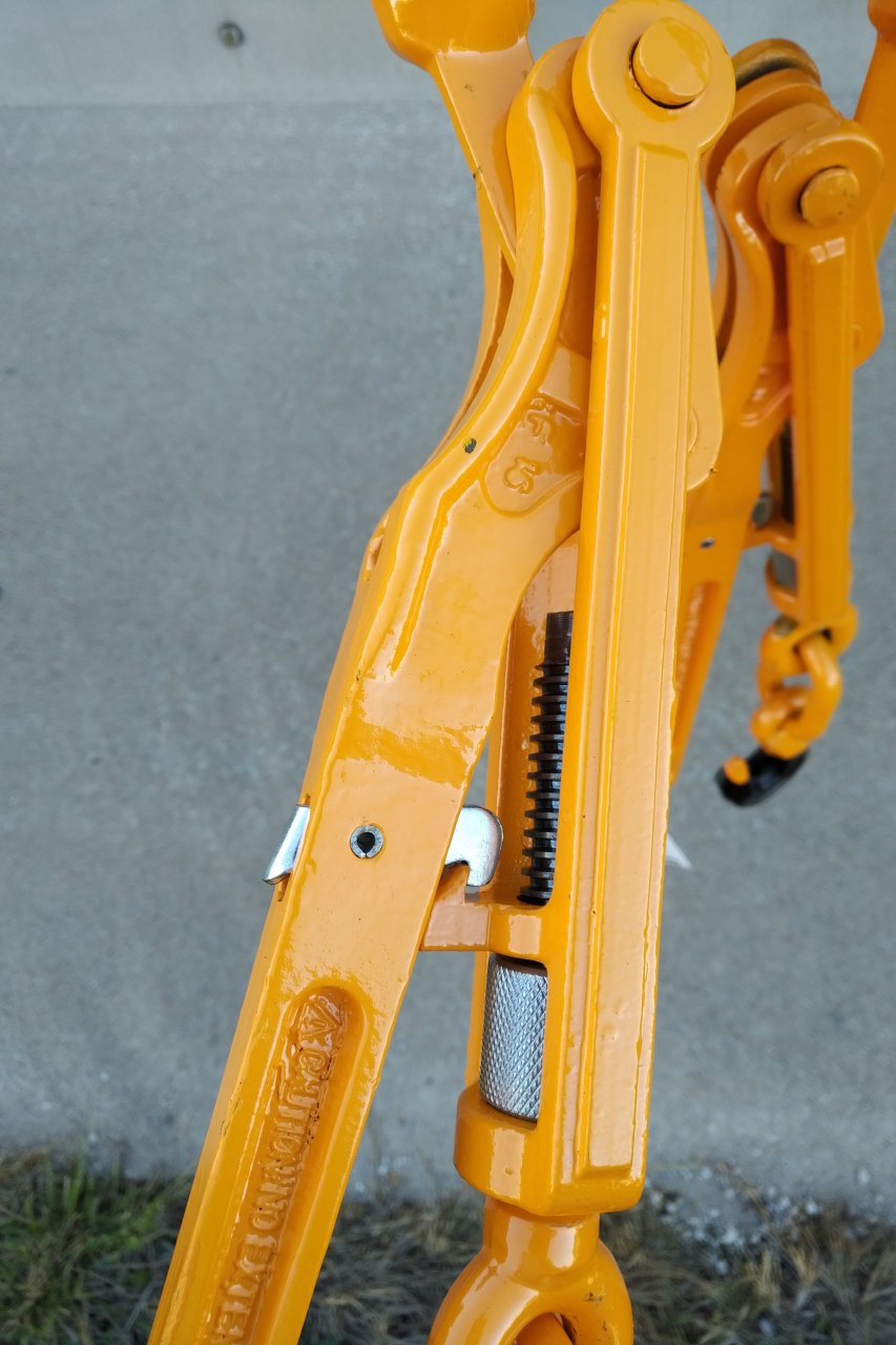

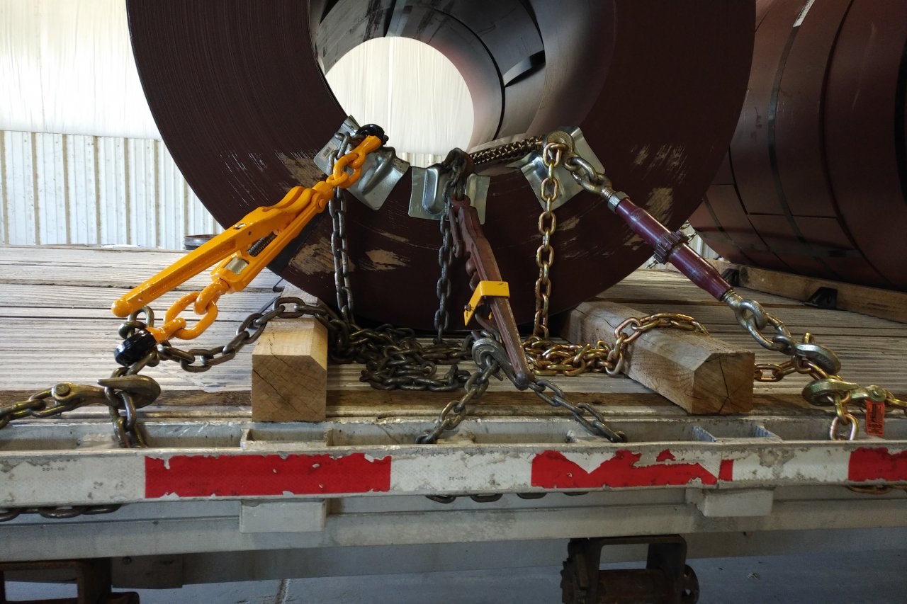

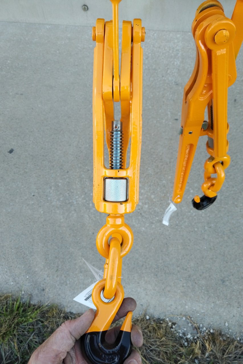

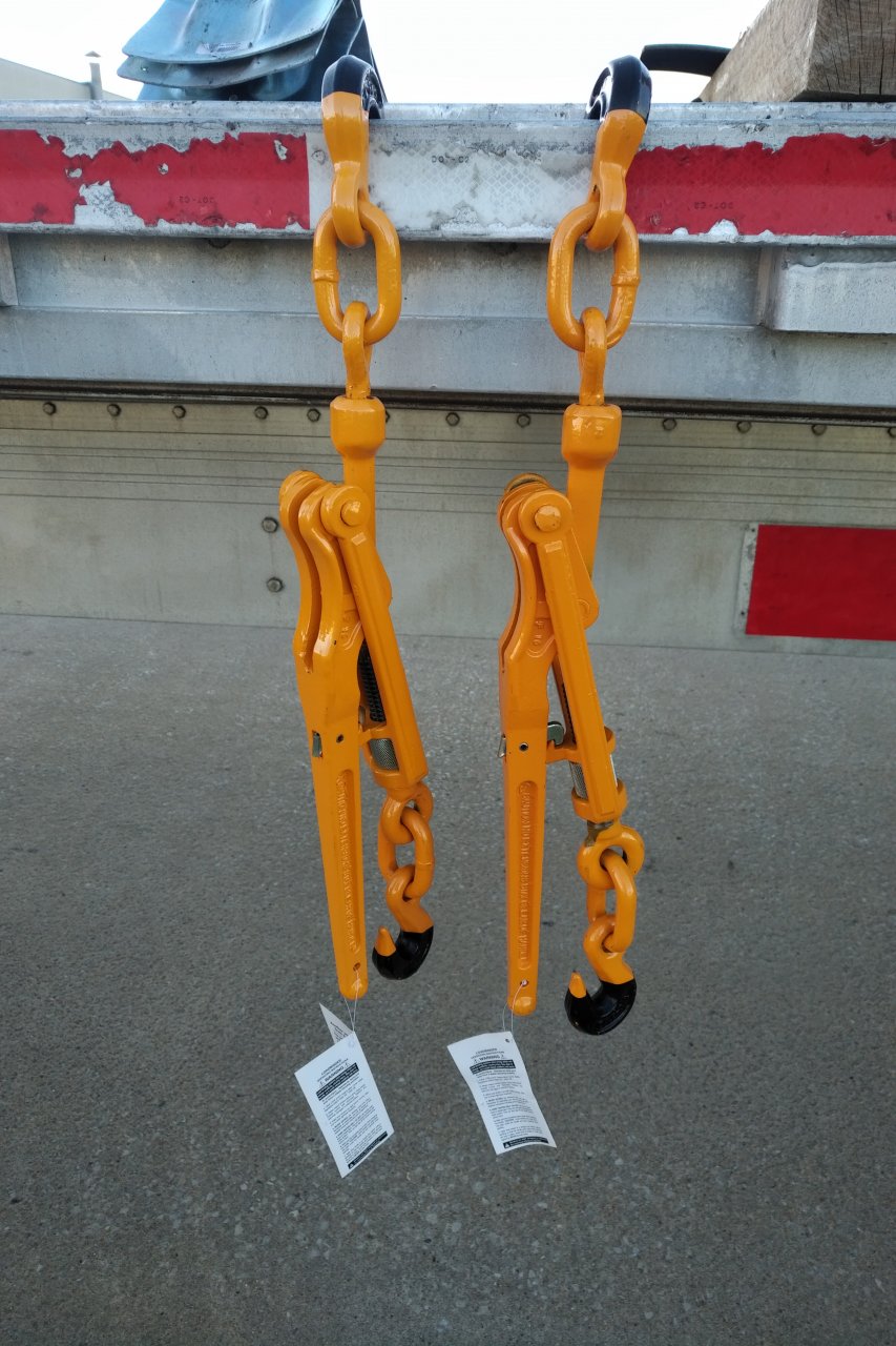

    I use snaps more than ratchets...quicker & easier. Only down side is the lack of adjustability. Sometimes, it's either too tight or too loose, with no in between. Picked up a couple of these, though, and so far I really like them. Completely eliminates the lack of adjustability problem, and as an added bonus they have a lock for the handle which saves time and effort securing that. I have clips I use on my other snaps to accomplish that...less work when it's an integral part of the binder.
    IMG_20171016_1729193.jpg IMG_20171016_1729390.jpg IMG_20171016_1729269.jpg IMG_20171016_1730056.jpg IMG_20171016_1729572.jpg IMG_20171018_1046549.jpg

    Any time the binder has to lie flat on the material being secured a snap binder is worlds easier.

    Course you can circumvent that issue with a couple of pieces of 2x4 under the screws

    Yes. The way I secure our pole bunks in the way back to the yard, my chains end up basically sitting in a corner. I'm sure I could make it happen with ratchet binders somehow, but it would be a major pain.
    Our company uses almost exclusively snaps. If I had my way, or my own equipment, I'd run an equal mix.
