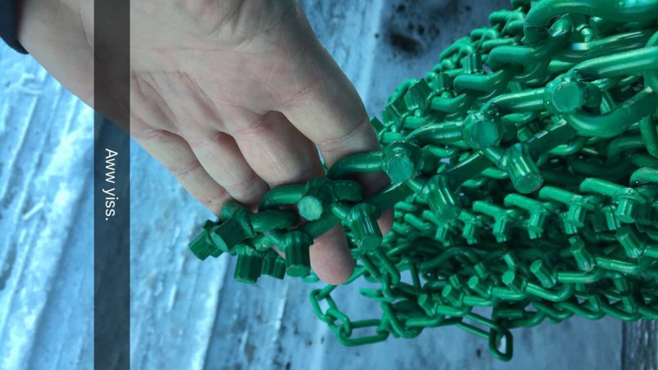

    A properly repaired set of chains is fine. I used to carry chain pliers and extra parts all the time. Where is the cross link breaking at? If it’s out in the middle you’re not getting your chains tight enough and they’re slapping the pavement every time they come around.

    I have no idea what these cost. But I didn’t take my pliers along or carry spare links anymore because the shop said I’d never be able to fix them along the road. I ran this set for two winters without any issues.
