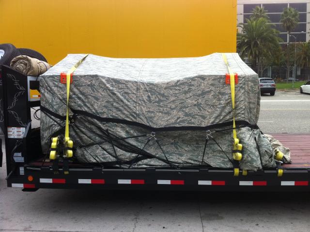

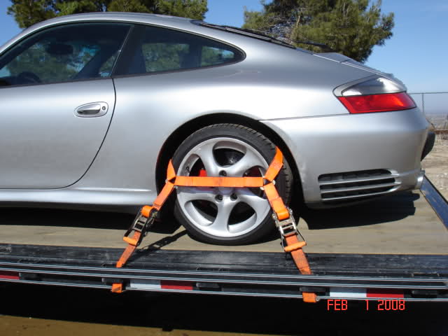

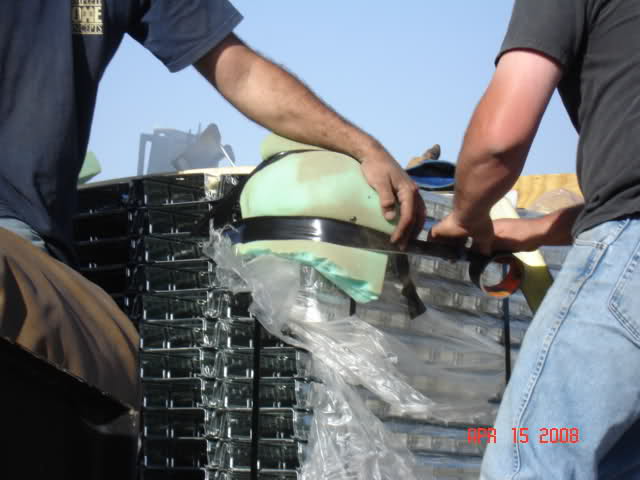

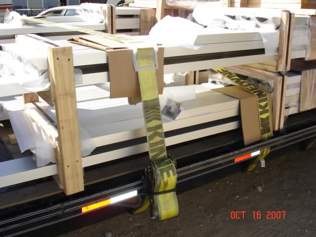

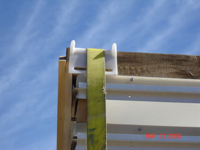

    Learning to tie freight down isn't that hard. Mostly common sense. I work with a lot of rookies I teach them how to tie freight down, and then I monitor them as long as they need me to.
    Best advice I can give you is,
    1. Before you start, read the FMCSA regulations regarding tie down.
    2. Visit a local truck stop and look at how all the different freight is tied down.
    3. Whenever you're in doubt about how much tie down gear needs to be used, tie it down the way you think it needs to be done and then add more tie down gear. There's no such thing as over tying a load down.
    4. Most guys running flatbed don't mind being asked for advice. Don't be afraid to ask another trucker how he's tie a particular piece of freight, or full load down.
    5. Padding is critical, any freight that's sharp that could cut a strap, or any freight that could be damaged needs to be protected with padding, or edge protectors. The last thing you want getting started is cargo insurance claims.
    I'll throw some pictures up here for you that I have handy. And I'll go dig up some more. Look at how the chains, straps, and padding are used.

    More tie down pictures,

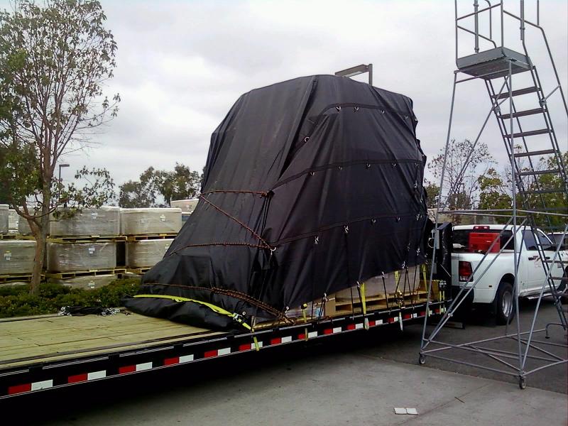

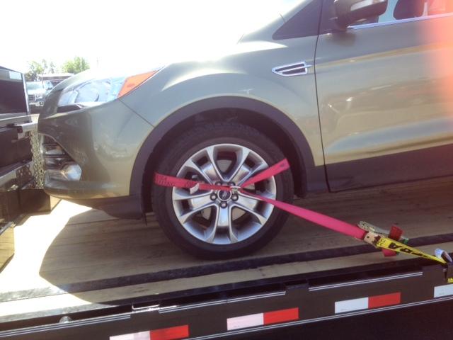

  4. flatbedcarrier
    flatbedcarrier Medium Load Member
    667
    826
    Jun 8, 2005
    Southern California
    A few more

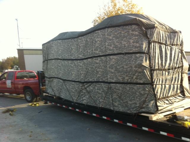

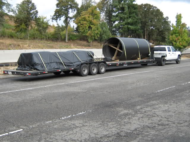

    There's a lot of other stuff you'll need to learn, like I said though it's mostly common sense.
    When you need to tarp a load make sure anything that could poke a hole in the tarp is padded before putting the tarp on. Also while tarping make sure your bungee cord hooks cannot rub a hole in the tarp, or into the freight under the tarp. Always face the hooks out, and the part of the hook that goes through the bungee cord should be bent closed. Always make sure the tarp is tight and isn't flapping in the wind while going down the road. A flapping tarp can damage freight, and it can also destroy the tarp. If a vinyl tarp flaps in the wind it'll cause the material to fracture. It'll look like tiny spiderweb cracks. Once that happens it will no longer keep water out where the fractures are located.
  6. flatbedcarrier
    667
    826
    Jun 8, 2005
    Southern California
    Tarped freight.
