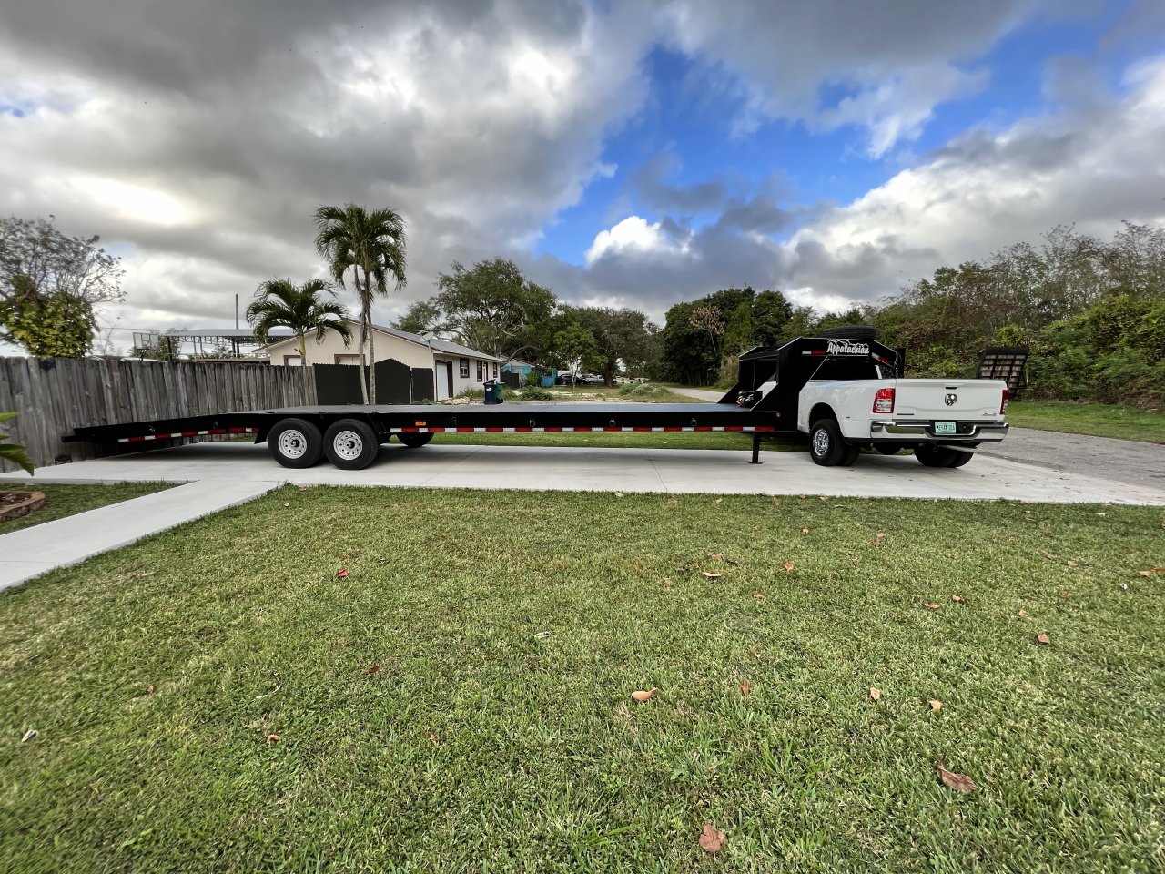

    In order to carry freight you need a 102” trailer, 40’? I’m using a car hauler with a solid steel deck, 82.5” wide and 36’ long, can’t haul freight with that? It’s a 15k rig. I’d like to be able to haul freight like the above posted.

    This is basically what I’m working with.

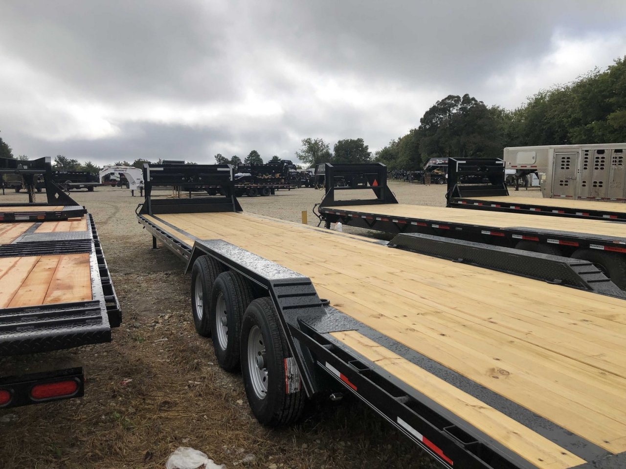

    You could probably modify your trailer so that you could haul some freight. You’d need to add to the sides, to it to make it 102” wide. It would require welding work.
    The big problem I have with your trailer is the steel deck. You’d need to really know what you’re doing when it comes to securing freight. Steel decks are very slippery.
    Depending on your situation, it may be smarter to sell that trailer and buy one that’s built to haul both, freight and vehicles.
    You really want that wood deck when it comes to hauling freight. Here’s a picture of the style trailer I run. It has a lower deck height then most trailers so I can get some taller freight, and vehicles on which can increase the rate per mile. It’s just a little more versatile then other trailers I’ve worked with. This style trailer is also less expensive (in more ways then one compared to a lot of others). These trailers cost approximately $14,000 brand new.

    Thats awesome, that’s exactly what I wanted but a bit limited to inventory down by south FL. Mine cost about the same, with some extras like the full diamond floor and winch but I am very limited to loads. I’ve contacted someone for the welding as well but aside from adding to the sides, all of not most of the D rings will have to be relocated. It’ll prob be best to sell or rent out.
    Where do they have those Delcos?
