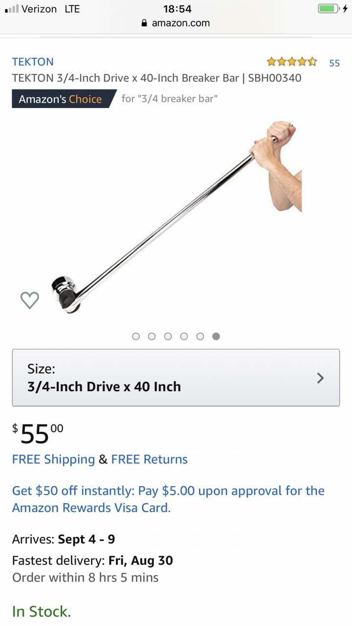

  8. PE_T
    PE_T Road Train Member
    I’m thinking about using a 3/4” long breaker bar to loosen up the lug nuts, and then finish it off with a Milwaukee impact.
    Rideandrepair Thanks this.

  11. starmac
    starmac Road Train Member
    6,639
    12,528
    Apr 11, 2019
    Fairbanks Ak
    With the setup I posted, it is quicker and waaaaay easier. As soon as you get it loose you just use the handle and that extension looking thing, and just spin them off and back on till you are ready to tighten them., then use the multiplier again. I have done it with a 4 foot breaker and a cheater pipe too at times, this just works so much easier, but like I said, I keep my impact so that the most I have to do with it now is break them loose.
