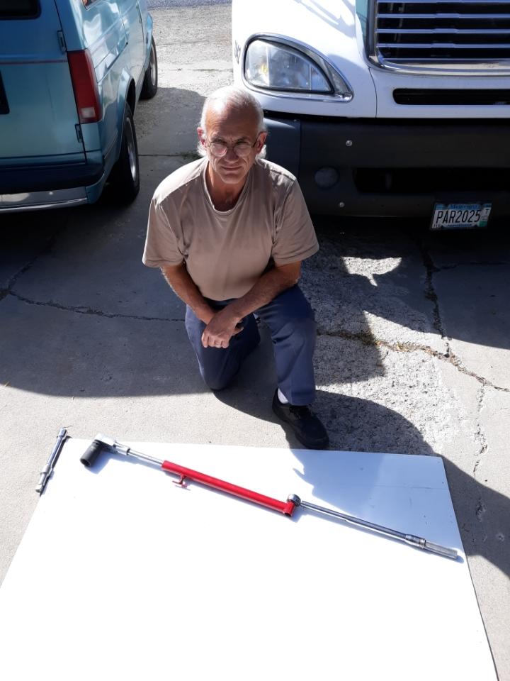

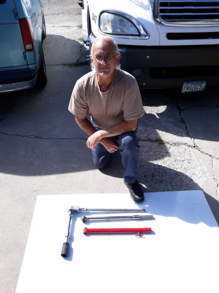

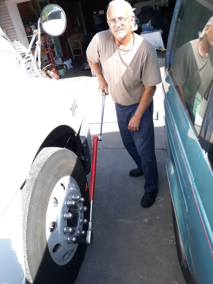

    I made this extension to use my 1/2 torque wrench to torque my wheels.
    Yes it is accurate as far as I can tell by where it retorqued the nut to where it was before loosening.
    There's a formula to use depending on the length of the extension.
    Rideandrepair and PE_T Thank this.
