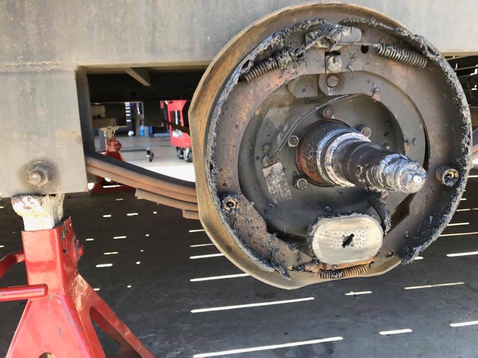

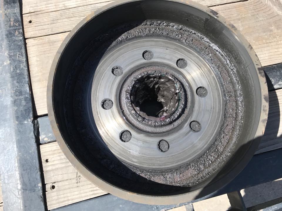

    With the types of hubs we run on our Hotshot lowboy trailers you want to regularly check hub temperature. When I stop for a safety check I walk around my trailer and reach down and feel to see if any of my hubs are running warmer than the rest. When one is running warmer that tells me i need to ad some grease to it. With a hand squeeze grease gun I’ll give it one, two, possibly even three trigger pulls of grease (no more than that) and then I’ll check it again another twenty or so miles down the road to see if it’s running cooler. if it’s still not running cool enough I’ll give it another click or two and then check it again to see if that cooled it down. If it’s not cooling down, it may need to be taken apart and inspected. A warm hub can quickly turn into a expensive repair if ignored.
    With these style hubs, you don’t want to ad to much grease at one time because it can bypass the inner seal and then you end up with grease getting inside the brake drum. Grease on your brake pads is not a good scenario. If that happens it’ll need to be taken apart, thoroughly cleaned, the seal replaced, and new pads installed. Never use a truck stop service bays air grease gun on these style trailer hubs because the air pressure is set way to high and it will blow the inner seal out. Carry your own hand pump grease gun in your tool box on the truck.
    To ad grease, you’ll need to pull the rubber cap on the axle hub cover. There’s a zerk fitting in the end of the axle right behind the rubber cap.
    With routinely checking hub temp the way I do, I rarely have any problems. The fact is I’ve gone 100,000 miles on these types of axles without having to pull a drum off.
    At 100,000 miles though, I do a complete tear down to inspect, do a complete brake job, and replace any suspension parts that are showing wear.
    All it takes is a few out of adjustment brakes to eat up the trucks brakes. These trailer brake parts are not very expensive. You can buy a complete backing plate kit for in the $50.00 range. A backing plate kit consists of the backing plate itself with all new brake parts attached to it. Replacing one is a very simple process. Remove the tire, remove the drum/hub. Then you have 5 bolts to remove, and two wires to disconnect. Then just reassemble. There’s videos to walk you through changing them on YouTube.
