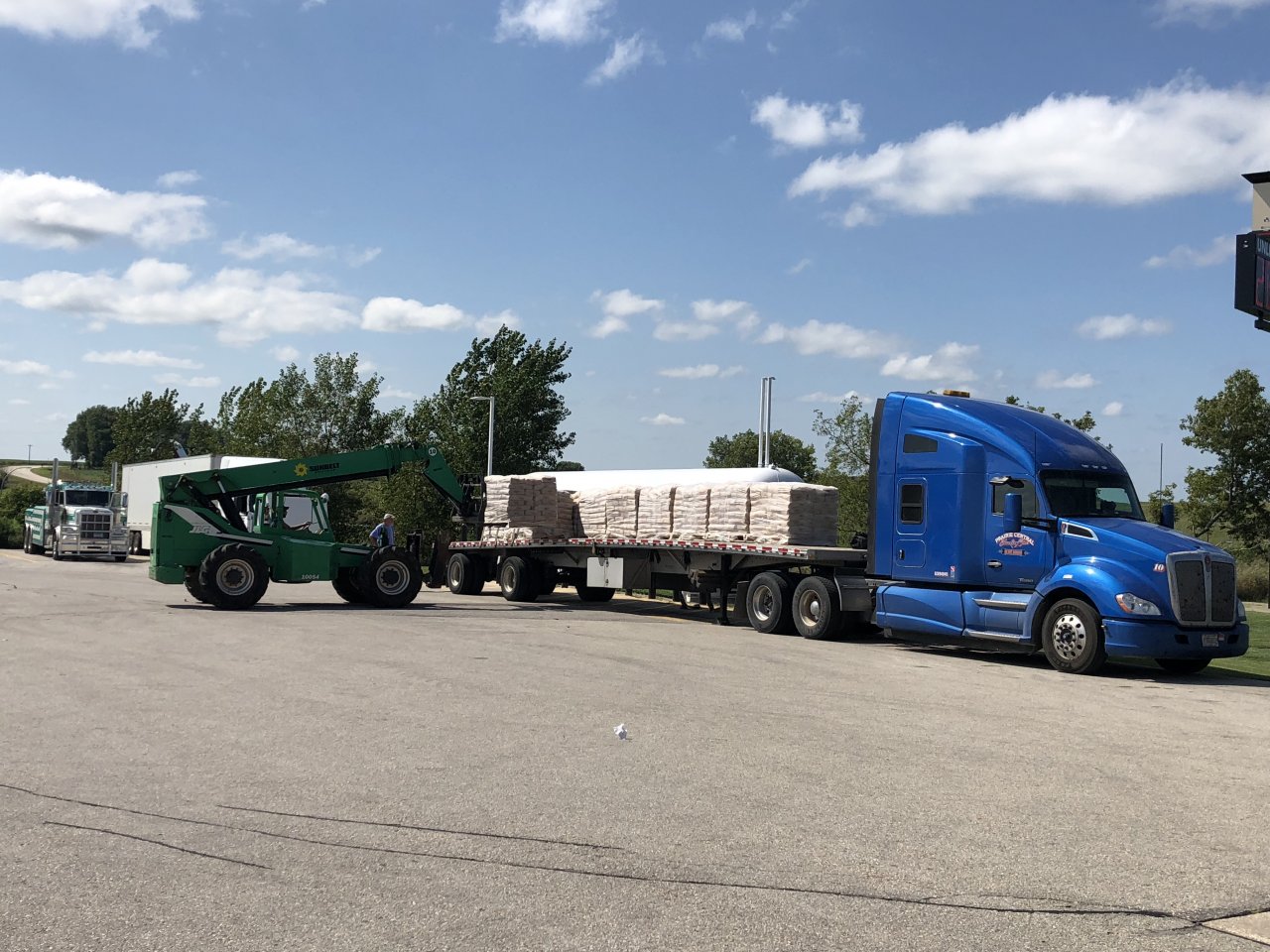

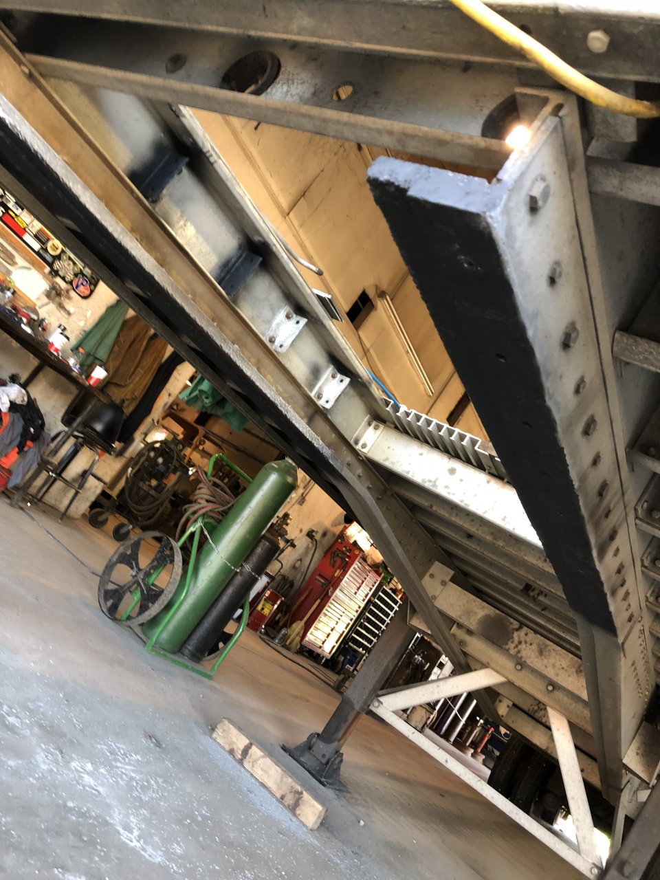

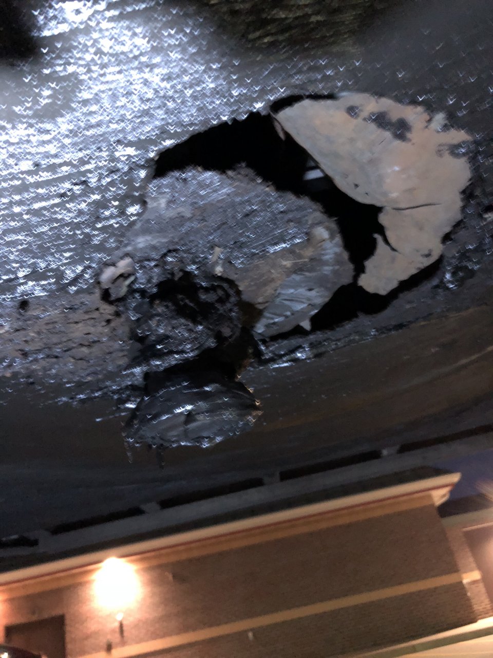

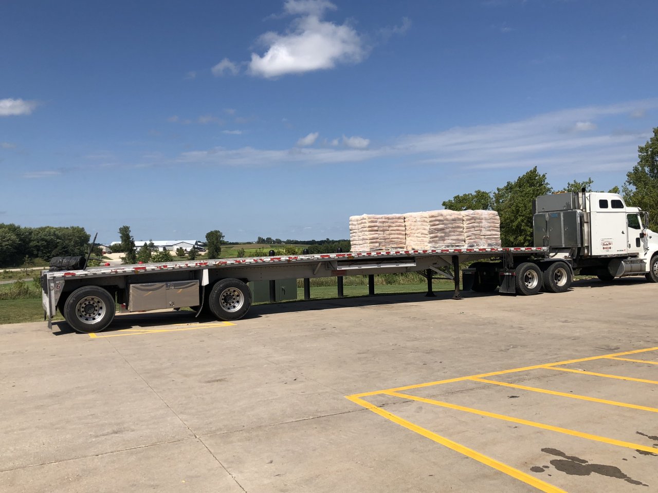

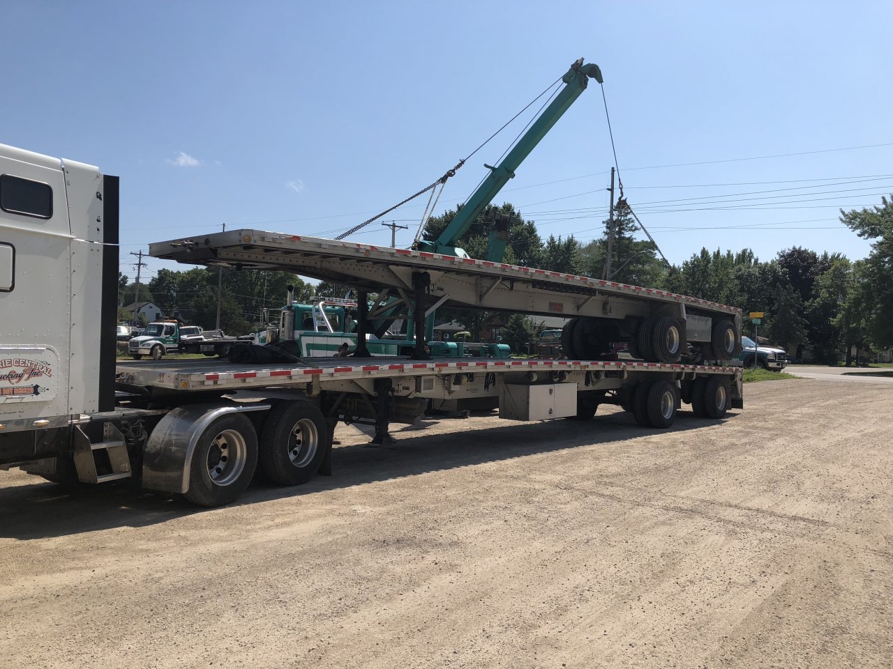

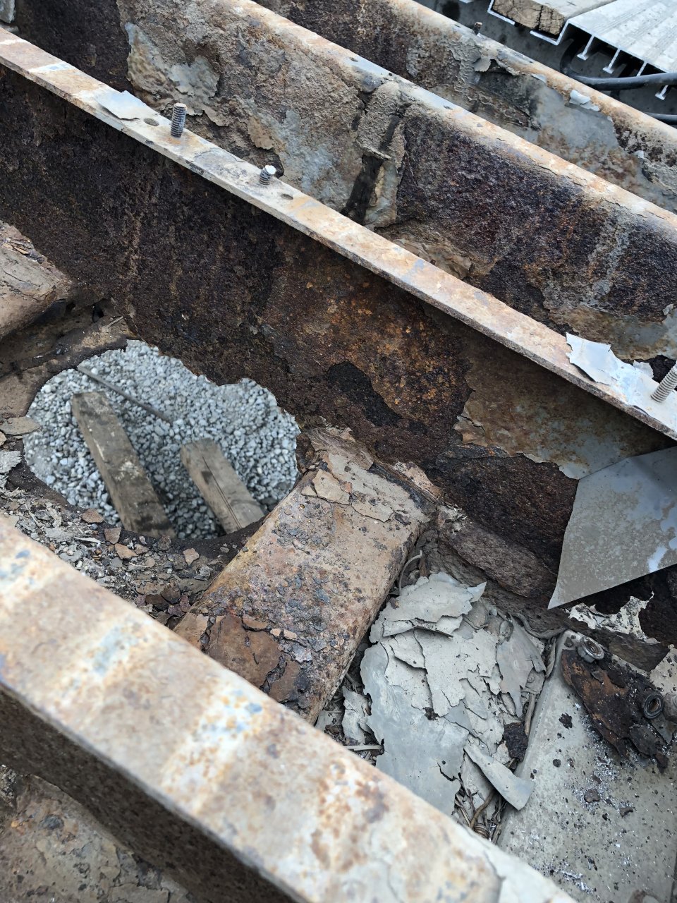

    Just when you think you got it all figured out...... 647F6FDD-BE70-4DB2-A7B3-35A544533AC9.jpeg E99FEDD8-54D7-4FCA-847B-08E2D1415628.jpeg 8811B5A6-3A7B-4234-8F1E-829B66D9FCBD.jpeg 2F34ED24-3E5C-48EB-9DA7-BC44C0164D4C.jpeg B1AD8390-1952-46F4-BDA3-6FB3C8930022.jpeg DE11006B-31E2-46F4-AD35-A77B0FA0969B.jpeg 11DA1246-89DB-4C25-BED3-B2A640B40E1B.jpeg didn’t cost me anything to have my company bring me an empty trailer. But it was $1900 to transfer the load and tow the bad trailer back to there yard. I had to finish the delivery 150 miles away. Then 150 miles back to get my broken trailer. Delivered trailer to repair place close to my house (400 miles away). 3 weeks of missed work and $4800 for the repair I’m finally going to pick up a load again in the morning. Could not see the damage damage until it happened. Trailer is only 10 years old.
    Easily $10,000.00 in cash and 3 weeks without revenue.
    I’m fine and was more than prepared for something like this but...........

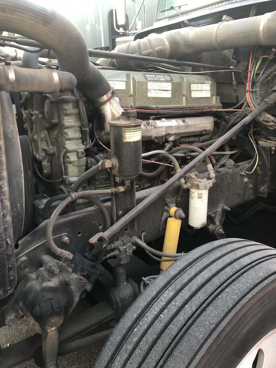

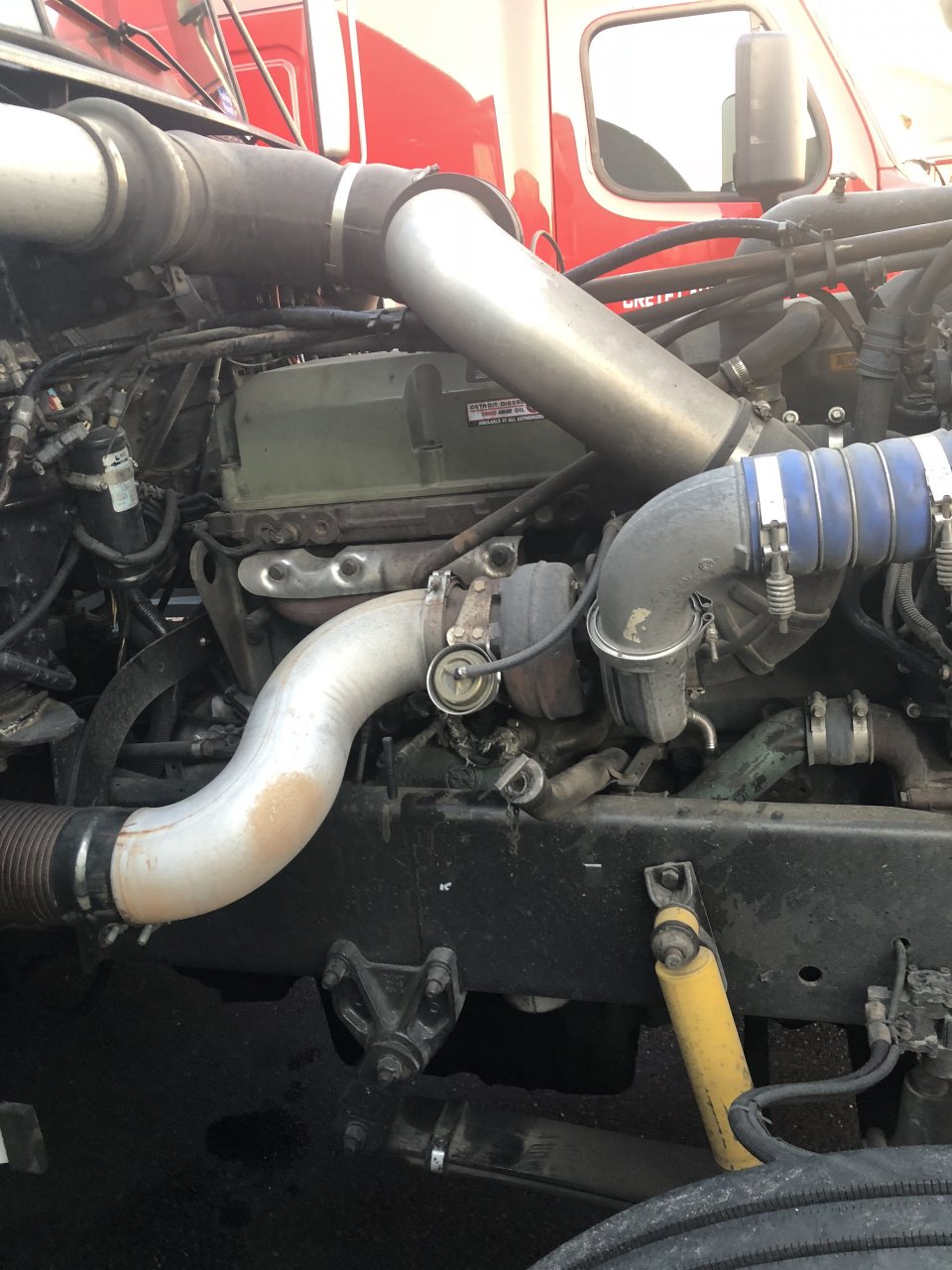

    AF0A40E8-7899-4003-9B40-26DC0504FA9E.jpeg F663A9B6-F6F2-4898-A403-9769E1F77B3C.jpeg I run avg 2800 wk 48 wks avg costs have been around 11 k per year . I am very happy with those #s . I now have 2.2 ml miles and am not hesitant of running it another million ( after overhaul) The old Conventional Trucks Classics w900. WS. Pete’s Or Internationals are simple and cheap to work on. Fuel mileage could be better. But ease of maintenance far outweighs this for me. Rather work a day on it at home then be stuck 4 days getting”Free”warranty work.Then running to catch up.see my Cummins Filter did away with expensive orig heated plastic bowl junk . Upgraded newer style 2003 S exhaust pipe. $50 at junkyard
