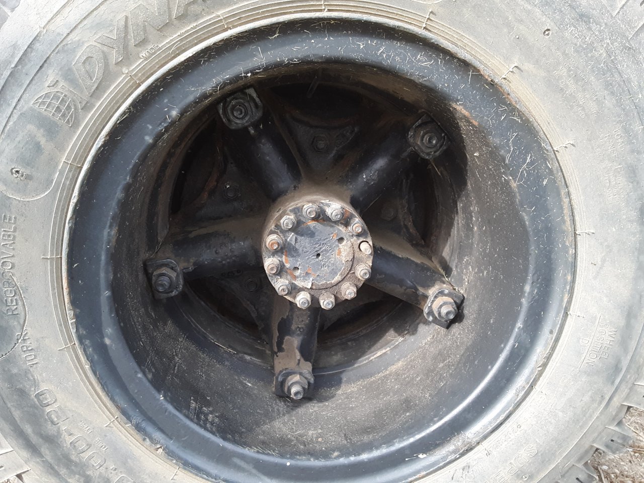

    I'm still learning about how to manage the duals. The extension on the driver's side, inside dual appears to have been knocked out of place. It's stuck back out of position, instead of poking through the outside rim. I bought a couple of parts for the inflation gun on the compressor in my shop... I haven't put them together and tried to get at that extension yet. I'm curious about this, because I road tested it (it's registered and insured... I have the 10 day temporary inspection to work with)... and it acts as if a tire has either a flat spot from being parked... or it's out of balance... or underinflated. Hard to describe... but... I'm familiar with tractors; if you park a tractor overnight on a cold night... the tires take a set; and the whole machine does a little "limp" or rocking action from side to side... until the tire warms up and gets back to round. This got MUCH better when I adjusted the pressure on the fronts... I'm wondering if there is a little bit of problem left with the rears.

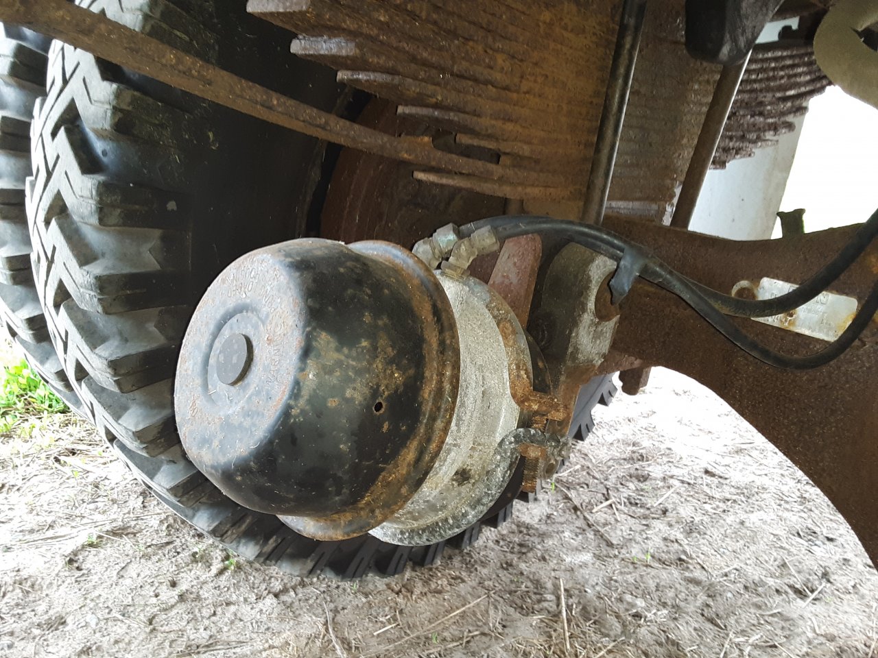

    The brakes work great, and the pressure system appears to work fine. I'm an engineer and a farmer, not a diesel mechanic or truck driver; so I haven't done a "leakdown test"... yet... but it holds. I will do a leakdown test soon...
    It actually holds "too well", because the parking brakes don't activate, even when I pull the button to engage. There must be a solenoid somewhere... or a valve.... any hints where to look would be appreciated.

    Sounds like you have Dayton rims. Big open rim on a cast iron spoke hub. They may just need to be repositioned on the hub. Could wright a page on how to do that. Put that with my 18.4 X 38 ( that is about 6 feet tall ) tractor tire with a nail in it. Aired it up and drove it to the tire shop in the morning. They broke it down, patched it and I picked it up that afternoon. They charged me $60 dollars. Yes I could do it myself but I made more money at work.
    Some of those old tires never round out. There are radials even for tube type rims anymore. Tubeless Dayton rims are not real expensive.
    Can we get a picture of the brake chamber on the rear axle?

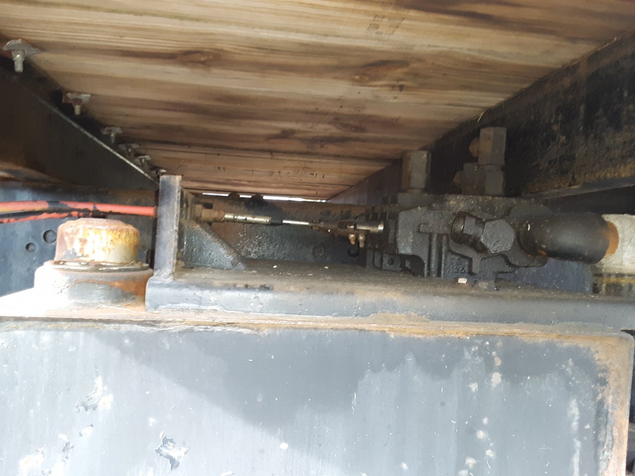

    So, here are some pictures of the brake systems around the rear axle...

    Some pictures of the rear rim.
