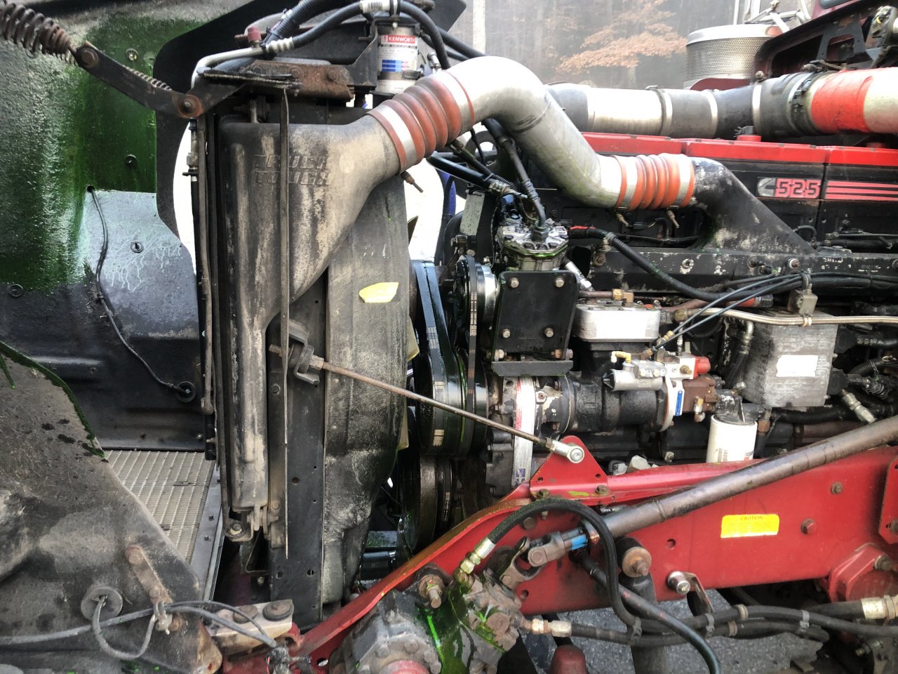

    As I start my second inframe in 3 years….

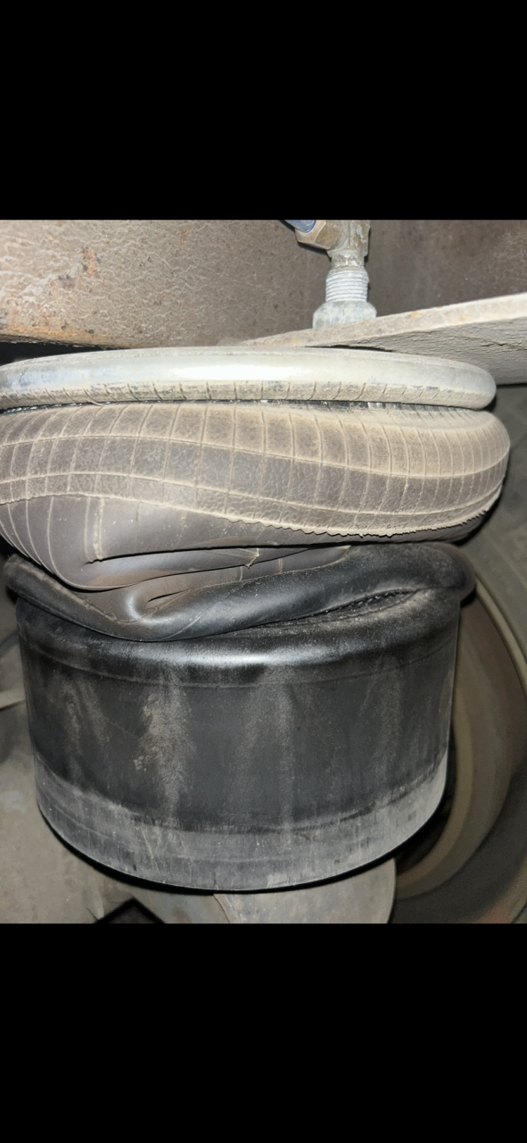

    4FAEC961-3C13-4FC6-B555-619732B95EE4.png Courtesy of a Spotter at Target Galesburg Mi. All 4 went back to normal, so I dropped the claim. Took a week off. While adding a few extra crossmembers, I noticed the welds on the whole right side rail were all broken. Paid $350 to have it welded back together. A week later, all the welds broke. Right now, as is, it’ll make a good storage Trailer. Either way, it’s pretty much worthless at this point.

    How many miles on the inframe?

  6. abyliks
    abyliks Road Train Member
    3,885
    9,080
    May 2, 2010
    ludlow MA
    just over 200k

  7. BigCam9670
    BigCam9670 Medium Load Member
    417
    4,585
    Jun 12, 2012
    Hudson, NY
    Did it have a major failure or its wore out already? N14 if I recall?

  9. abyliks
    3,885
    9,080
    May 2, 2010
    ludlow MA
    cracked front head, dumped fuel into the oil, started loosing oil pressure, sounds like I might get lucky and get away with just a head and not have wiped out then bottom end but I’ll know for sure later today,

  11. abyliks
    3,885
    9,080
    May 2, 2010
    ludlow MA
    Eh Getting pissed off isn’t going to make it cost less or magically fix it so not much else I can do, 5 weeks ago my biggest worry was the tax man, think we’re going to be good for write offs this year now
