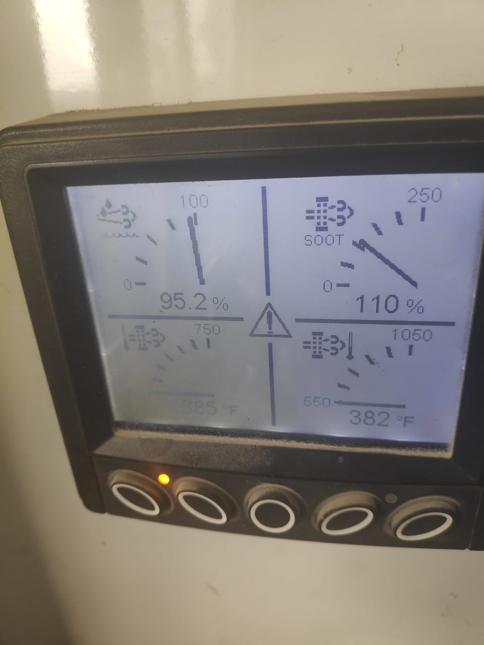

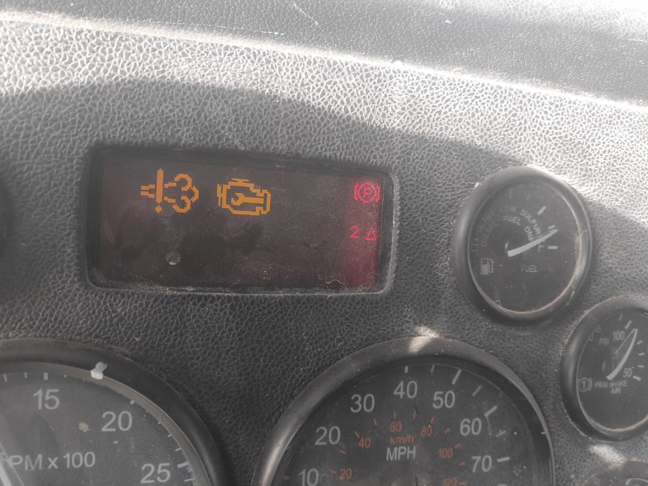

    I have Peterbilt 365 Truck with Cummins ISX12. I always have a problem that the soot is build up quickly and the warning lite is on. After the engine starting to shutdown every 30 min. So I have to make regen manualy or by Cummins software but again soot build up maybe after on day or a week as max.
    In my country we used high sulfur content in diesel
    I don't know if this affecting on the engine

    It could be time to clean your dpf.

    High sulfur diesel is a no go. Looks like it will need a dpf cleaning/replacement as well as checking for excessive soot leaving the engine. If you are going to continue to use the incorrect diesel might as well remove the troubled parts.
