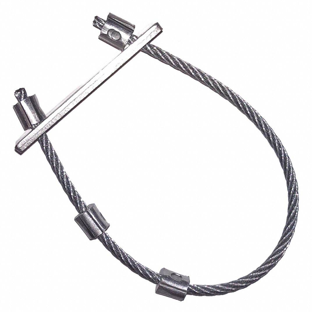

    Nope. I usually like mentioned already, wrapped the excess chain around the handle, and then used a bungee and wrapped the chain, but when they started frowning on that, I got a few of the snap binder lever locks:
    Simple and effective solution to avoid a possible violation. :)
    Blue jeans, cke, D.Tibbitt and 4 others Thank this.

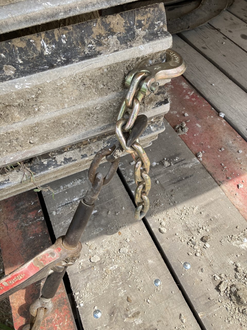

    Never had a snap binder come loose unless some other action made the chain get loose first. I hardly ever use them because on half inch chains it’s hard to find the happy spot between can’t get it snapped and loose especially when you’re only using a couple links.
    On small chains or longer chains they stretch enough that it’s easy to find the right spot.
    Most of my tie down happens like this
    and like oldschooler suggested I always try to block the handle so it can’t back off
    Blue jeans, CAXPT, Ruthless and 3 others Thank this.
