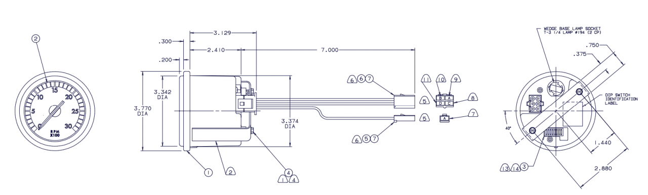

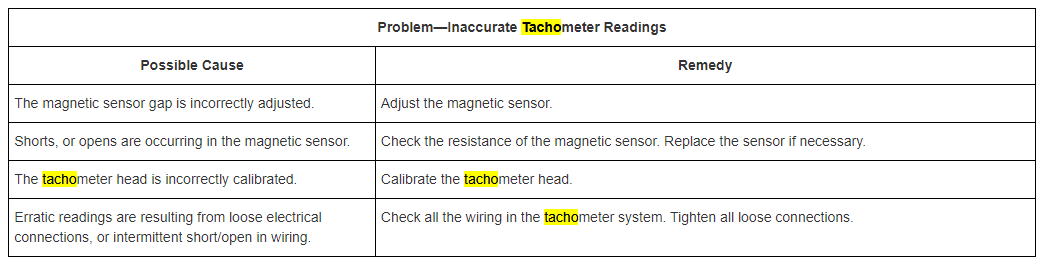

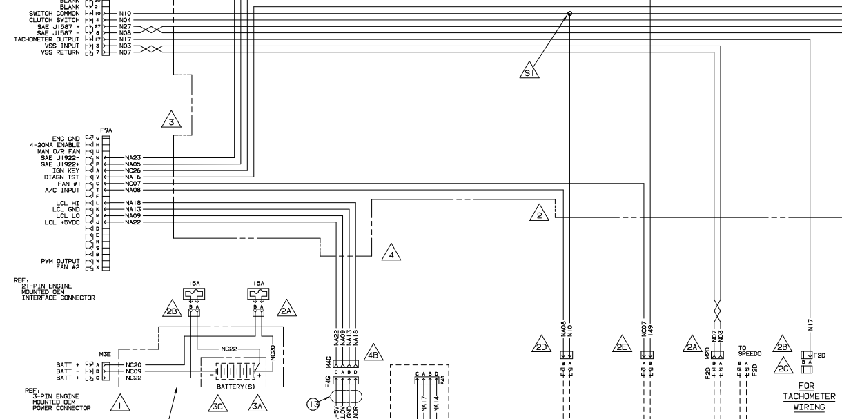

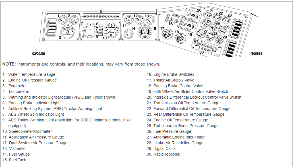

    Here is your Tachometer. On the back of it, there are "dip-switches" for calibrating the tach. DONT MESS WITH THESE--but do note their position.
    This is the schematic of the "connector" portion of the gauge:
    Here is the signal CIRC 162 wiring as the Tachometer output:
    This is some of the T/S that is worthwhile to check. I wonder if you have a bad ground to the tach, or one of the signal wires from the sensor:

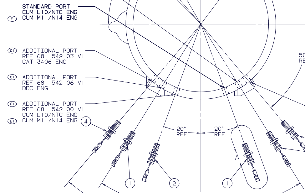

    The tachometer sensor is in the flywheel housing. On a Cummins N14, it should be on the bottom--about the 5-oclock position.
    Report back what you find out!

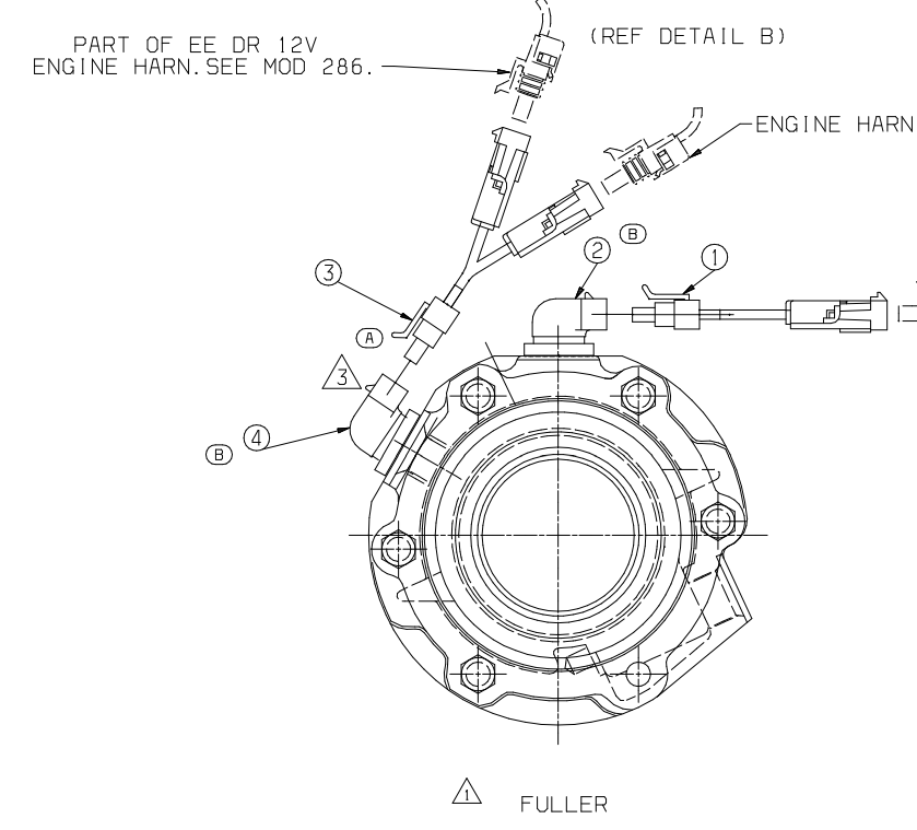

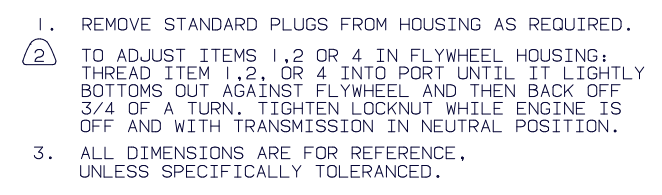

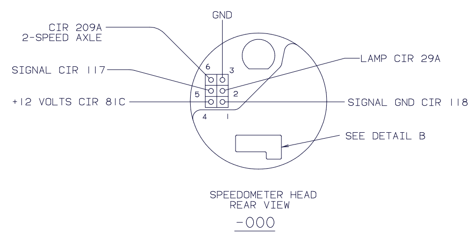

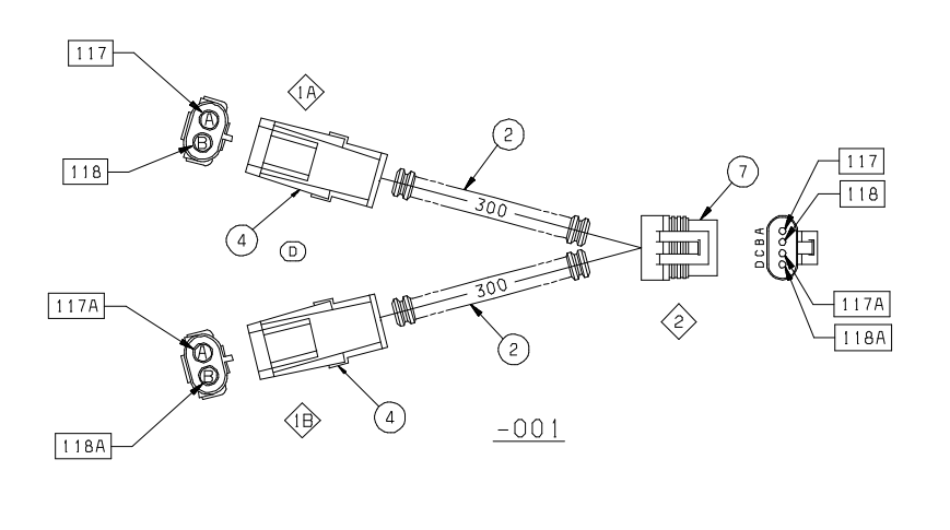

    Wiring for the speedometer (similar to tach):
    The VSS pigtail does split off into two as per the build of your truck, notice the CIRC 117 and 118 that goes to the speedometer:
    The sensor and harness split is down at the tail-shaft of transmission. The split is because the ECM wants to know the VSS for purposes of cruise control:
    I suspect the sensor is bad, and any "shifting" is causing the sensor to interpret erratic speed. Get a new one and try it out.

    Wonder if it is the harness and not the sensor, I had a WS that did some wonky things and it turned out to be the harness on the trans had an open ground that any movement would cause it to connect back up.
