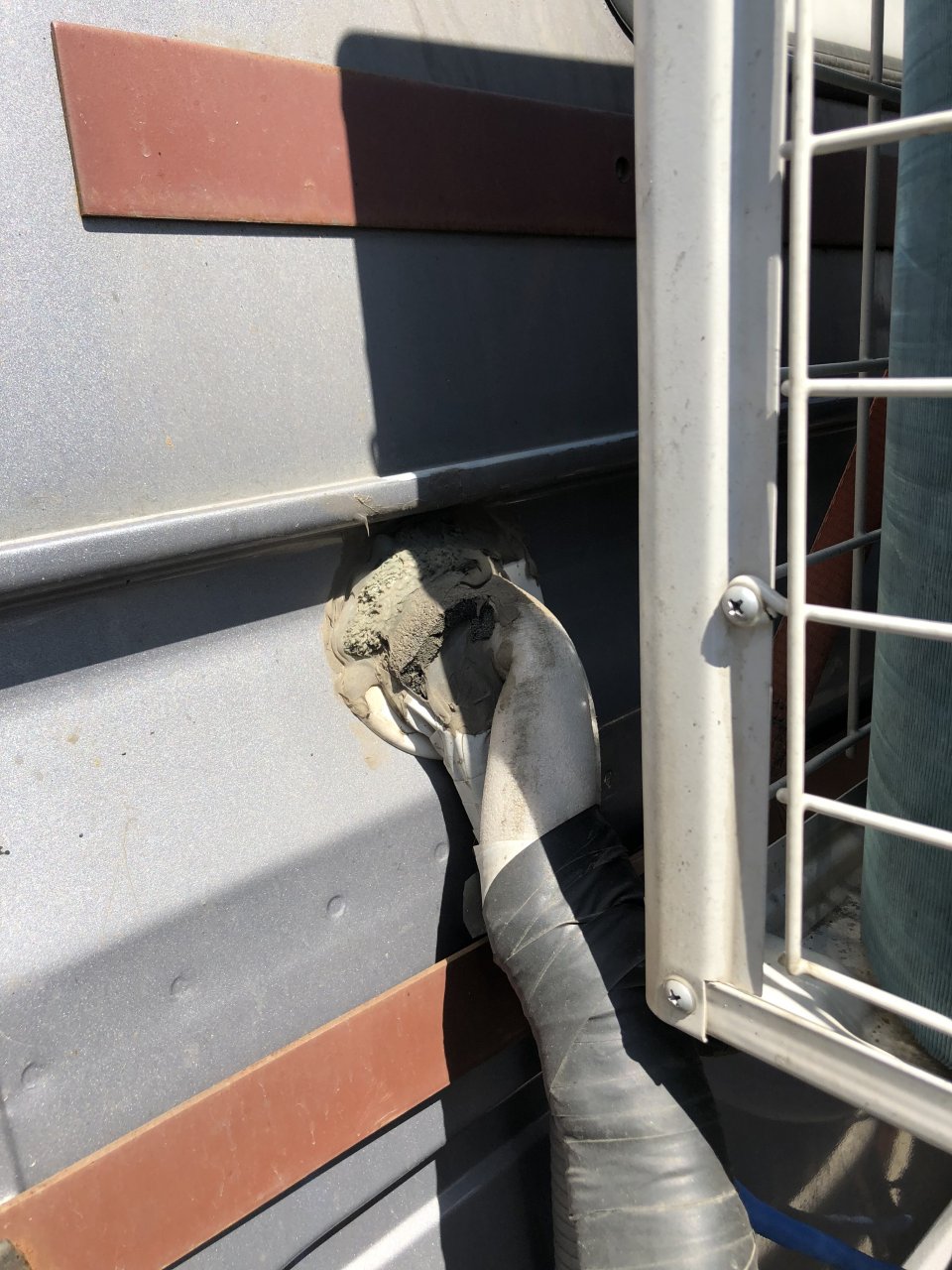

    55819C2F-9961-40C3-B8C5-1B755B603C74.jpeg 2F30FB8B-9B83-47B9-BEAB-91932DA95155.jpeg 1653C8E7-5828-43A4-9919-C9FFE343D5EB.jpeg 5A3EFBB0-8D18-47A1-B81C-BDCE4E0D7B14.jpeg F8929364-3FD2-4C23-8FD1-2775ABF3559D.jpeg
    It helps if you already have thread holes for fairings that you could tap into. Then you could build your mounting rack based off those deminsions. I got my blueprint pretty much from snailexpress too. Took about three days and some guts lol... guts to drill holes through the truck that is
    My generator could use a bath. But got a pretty nice aluminum box from KSH that has the pull outs for exhaust and front control operations. Had to modify it a little so I could change/top oil off on the field.
