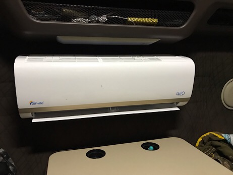

    And @4rdtruck ... I installed a 12,000 BTU, 110v Senville a couple months ago. The only thing I don't like about it is that the evaporator drain is on the driver's side. If I park on the street where the road is crowned, it won't drain and leaks water inside. I either have to park left to curb or find a relatively flat spot.
    As far as cooling though, I love it. It only uses 223 watts while it's running so the generator is barely breathing hard and sips gas. I burn $3 to $4 worth of gas a day which includes running it at shippers and receivers, as well as sleeping overnight.

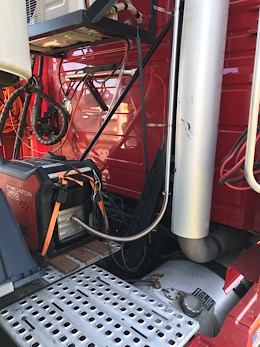

    Another note, please be kind to your fellow drivers and install an exhaust stack. I had problems with my carbon monoxide detector going off all the time before I did that.
    It's just an Espar heater flex pipe connected to eight feet of 3/4" conduit. Some Permatex Ultra Copper seals the connections. Blows the exhaust straight up in the air above the cab.

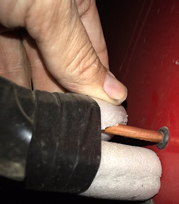

    No lines or electrical show on the inside, everything is concealed behind the fabric panel. And because the evaporator and condenser are mounted right behind each other, there's only about a foot and a half of refrigerant lines. I cut them off and reflared the ends to fit exactly. Each refrigerant line, one electric line and the drain have their own hole drilled with an exact fitting rubber grommet. So no gobs of sealant or giant holes in the cab. If I wanted to remove it, the holes could be plugged with plastic body grommets.

    I used the copper lines it came with, I just cut them to fit. I got rubber grommets from the hardware store and used a step drill to cut the holes for them exact.
    Because the lines are so short and the inside and outside units are mounted so close together, I don't think vibration will be a problem. They are literally back to back.
    I researched and couldn't find any rubber hose that will withstand the pressures of 410a refrigerant. I inspect the lines regularly and haven't seen any evidence of wear.
