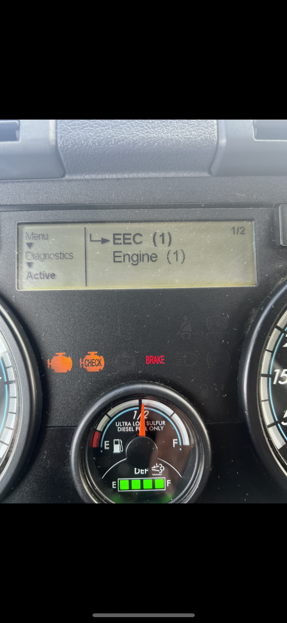

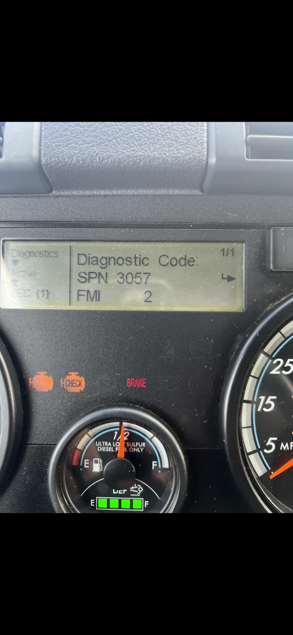

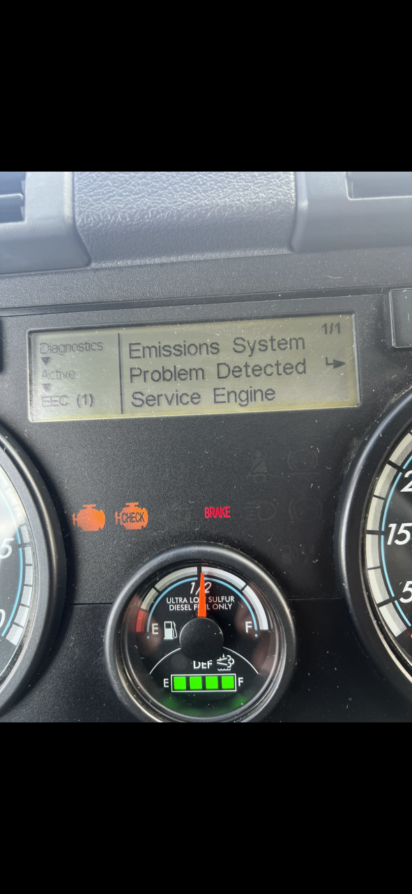

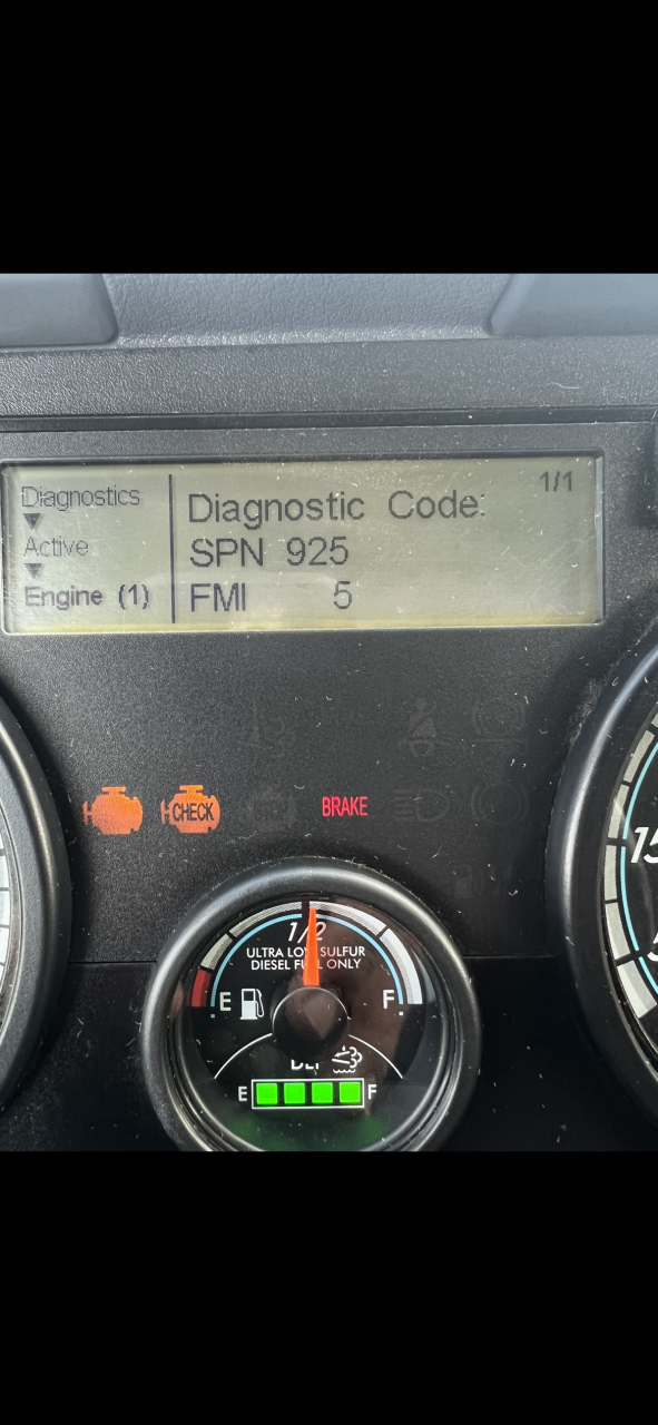

Hello everyone, I’m facing the same problem with my 2015 freightliner Cascadia, Both the check engine lights are on when I check in the Diagnostics the codes I get I have attached the pictures, if anyone can help guide me what to do or where to go it will be much appreciated ( I’m from Indiana) any mechanic that can fix this issue I can go to him. Thanks
Replace the optimize idle alarm unit, like I did. Get one at freightliner, it's like 25 bucks and it takes 5 minutes to replace, very easy to do it yourself
Japp Thanks this. -
the optimize idle doesn’t work in my truck the person who had it before me deleted it, so should I still get the alarm unit and replace it?
I'm guessing the engine control unit is still finding the fault in the alarm even though the optimized idle is disabled. I guess you can either replace the alarm or just ignore the check engine lights because they don't indicate anything actually bad. I wouldn't recommend that though, if something bad actually happens and you get a real important check engine light, you won't notice
