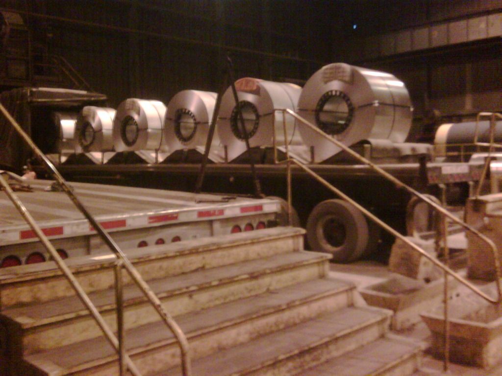

that's what I like about spread. at times I will have to load several coils, 4 stand up's, 3 skid's, e.t.c. making enough room to chain down, between the coils & spacing so that I am not over on any axle, A spread allows for leeway if not exactly centered, where a tandem, being at your gross, you better have it just right. having to load several pieces that are all different in weight can pose a lil challenge. have to do some calculating.
