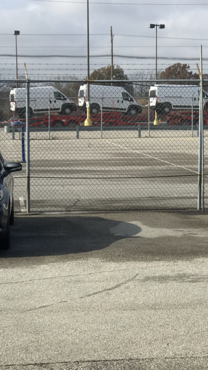

    Not my rig and not a high rail, but is this anything like what you are planning to haul?

    Just looking at the safety posts on the tractor I thought this would be a low load. Guess I was wrong.

    Looks great but this is a low side. Those look like mid-roofs. The top table on this trailer will come down significantly lower than my 7 car. Im just assuming he has a trailer like mine.

    That’s what I was thinking but wasn’t sure. I have never measured my top deck compared to a quick loader but it looks very close when bottomed out.
