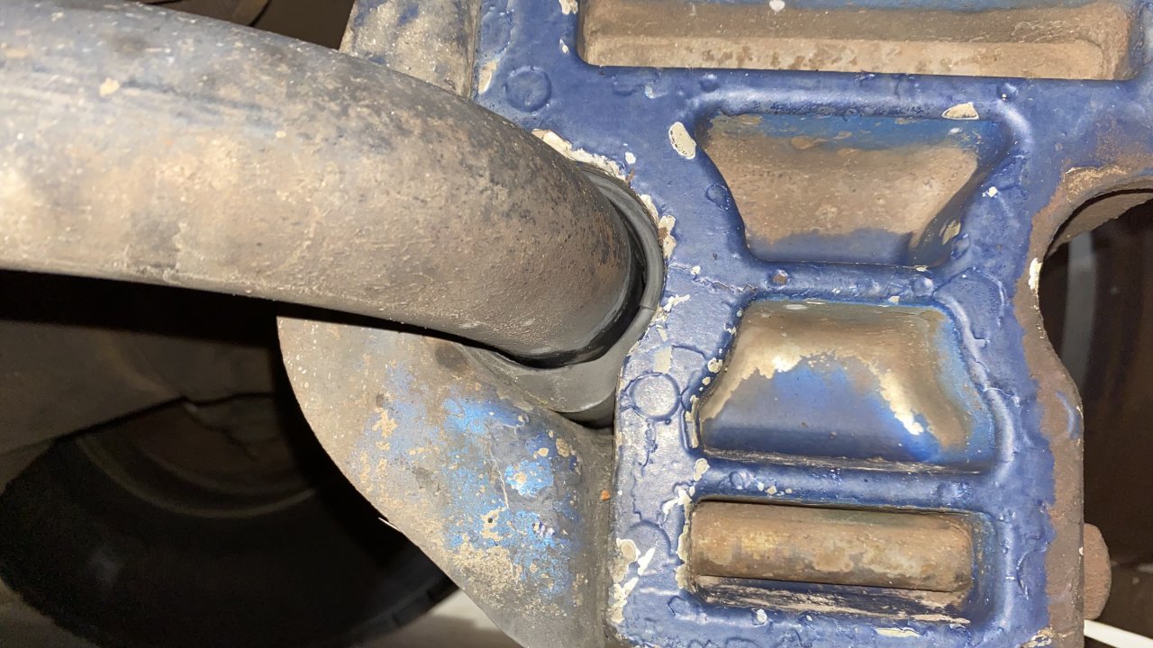

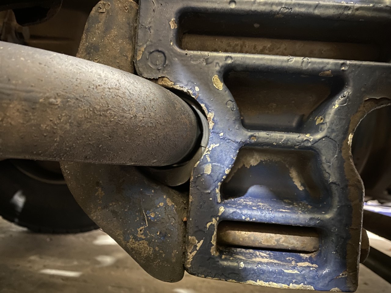

    Being dual pedestal and this is the front pedestal where the wear is, you have to drag the front axle back, compressing the jack shaft. Easiest way now I look at it is to take the front axle wheels off and drop the stabiliser bar entirely. Shouldn’t be too hard. What do you think of the wear? Can it wait or should I do it over the weekend? Rear stabiliser bar and all other bushes look good.

    I’ve seen worse but if it was mine I wouldn’t put it off for very long

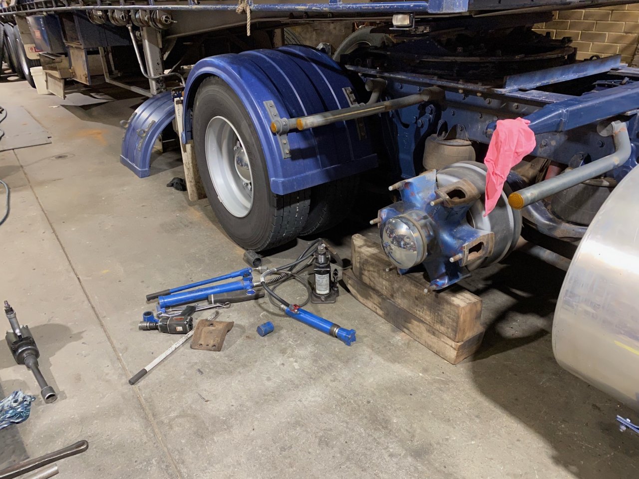

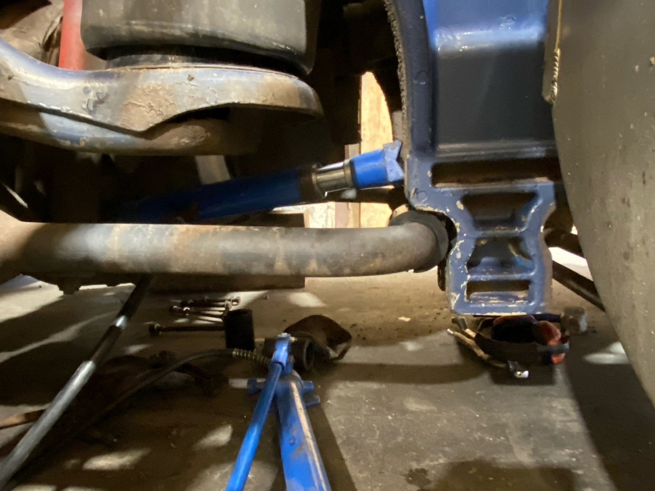

    I put new ones in yesterday. Took about two hours of work time. Much easier if you take the wheels off. Only the front axle needed doing. When all the other bushes on the suspension eventually wear out out I’ll do the whole lot next time. I replaced all the bushes a few years ago, not a huge or difficult job, just time consuming. D122BFD2-0DB8-4947-AF6C-27E6EF428517.jpeg 791C6F5E-7803-4FEF-B51C-12E87500D5BB.jpeg
