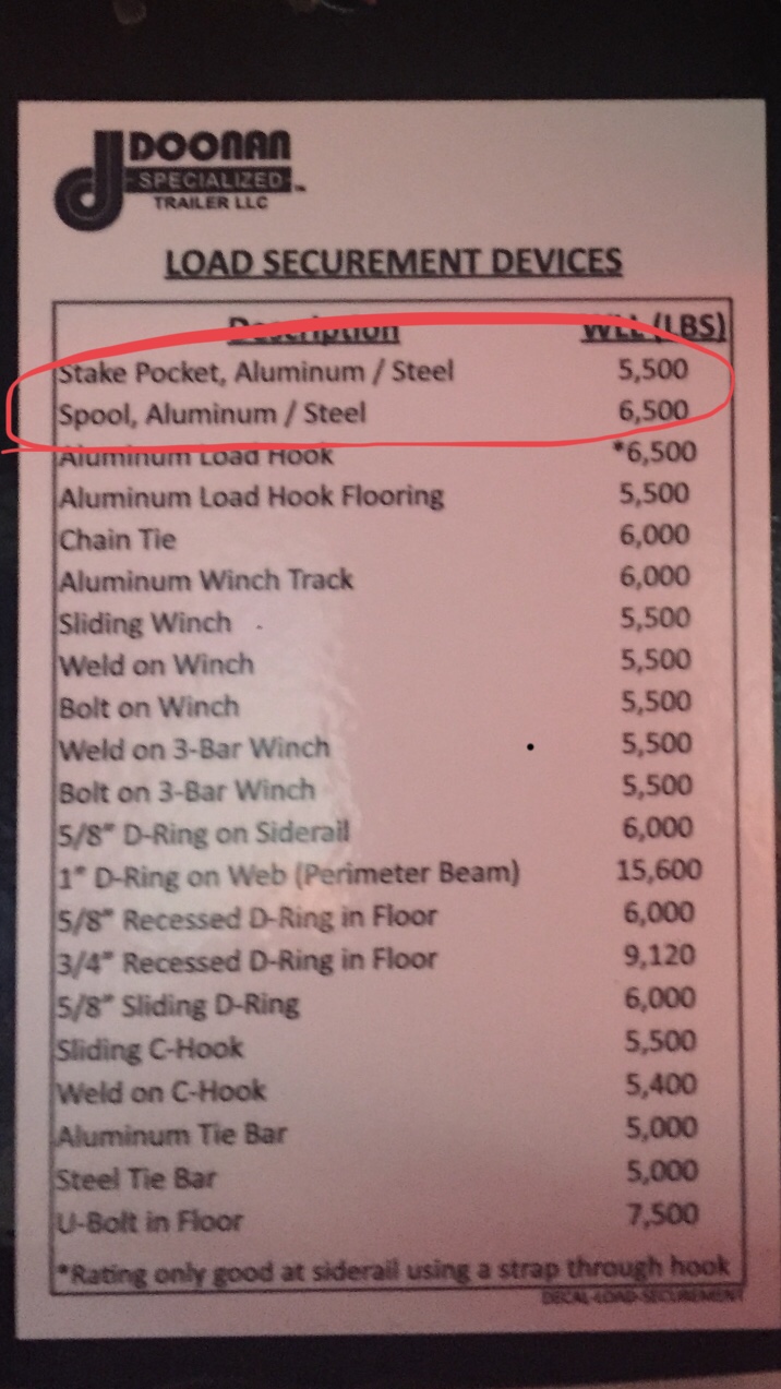

    On pretty much every trailer, they and the rub rails are only designed to stop straps from getting cut in the event of a rollover. Anything hooked to them is a way to bend them
  5. johndeere4020
    8,522
    119,293
    Jan 1, 2010
    Umm, no.
    lester, kylefitzy and cke Thank this.
  6. Nothereoften
    Nothereoften Light Load Member
    261
    265
    Oct 6, 2018
    Call your manufacturer and ask them
  7. johndeere4020
    8,522
    119,293
    Jan 1, 2010
    I don’t have to it’s listed right on the side of the trailer.
    kylefitzy Thanks this.
  8. johndeere4020
    8,522
    119,293
    Jan 1, 2010
    541FEA88-A7EB-4001-A28F-BC218AFD8EDC.jpeg C5D318CB-0265-4E39-A440-3353BF1EEF0E.jpeg
    IH Truck Guy, cke, Tug Toy and 2 others Thank this.
  9. Razororange
    Razororange Road Train Member
    2,538
    24,285
    Dec 20, 2011
    Milwaukee, WI
    All 4 of my Benson trailers have a big yellow sticker on the frame listing Stake Pockets at 5000lbs and a strap hook on the rub rail at 5500lbs.
