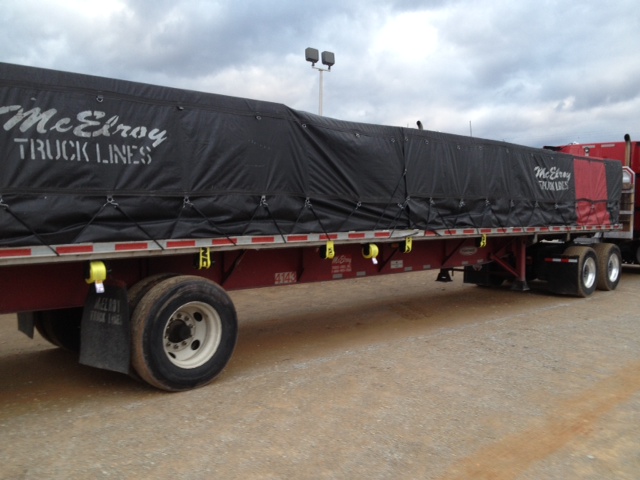

Here's a shot of the same load from the other side. I don't know, but not too bad for my first one all by myself. Bottom line, it didn't flop in the breeze goin' down the road, the tarp didn't fly off the load, & the load was delivered on time!

Looks pretty good. Only thing I'd change is that I keep everything inside the rub rails if at all possible. Even bungies. Not only does this keep them from getting damage if something rubs the rub rail, but it also keeps them tighter against the tarps and gives them more contact area to hold them against the load/keep the tarps from flapping. Also, it looks like the tarps are just a tad crumpled at the bottom. You could prolly roll the excess a little tighter and take that out. But, that's definitely a great job for a first time solo tarp job. Course, it helps to have a square load.
But it looks like you were trained well. Now the real test will be when you get a parts load with all kinds of nice sharp, metal jaggies and irregular pieces! Those are... well... let's just say "fun."
Edit: Also, just saw that one strap is pretty close to the front axle of the spread. Doubt it'd be an issue just thought I'd mention it in case your trainer didn't, but you really want to avoid putting a strap ratchet over a tire. Where that one is shouldn't hurt unless your load is stupid heavy (and could therefore compress the suspension alot) or if you hit really bumpy roads. But much further back and it really can become an issue with the ratchet digging into the tire. -
Thanks for the comments, Raezzor! Yeah, I learned just the other night about not placing the ratchet straps over a tire. Got stopped for the night, set the brakes. Apparently the thing just sat down on the rear axle pretty good & the heat from the tire melted the strap. I found it as I was going around undoing most of the bungees (leave a few on just in case a big wind blows up during the night) & unstrapping, prepping for the early A.M. unload. I simply replaced the strap & thought, "Lesson learned! From now on, only portables over the tires!" lol That that could happen had not occurred to me, nor had it ever been brought to my attention.
Good advice on the bungees inside the rub rail, too. While on the trainer truck I was actually running the ones I was hooking behind the rub rail on the first load we picked up. Trainer saw me & said it wasn't really necessary. First thought that came to my mind was, "Hmm...we run the straps behind the rub rail to avoid possible damage to the straps, so why is it any different for the bungees?" But hey, I just figured his truck, his load, his rules. Guess it's a semi-bad habit I developed.
What you say about running the bungees behind the rub rail helping to reduce flapping makes logical sense, too. Thanks for the heads-up! I appreciate the critique & advice.
