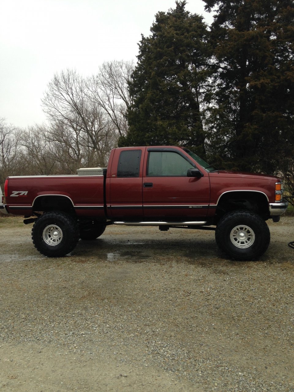

    My trusty Chevrolet set for over a year first time and 9 months the second time I was deployed in Iraq in 03 and 05. Started her up both times and changed oil after a cruise. Still have it, but it hasn't rolled over 70,000 miles. 1667.jpeg
    Now, you said Ford so cross your fingers! It should be fine.
