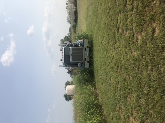

    I’m preparing to move a 1973 Pete with a 3406A this weekend. I’ve only got to move it avout 1/2 to my shop but it’s been sitting for about 5 years. Any tips?
