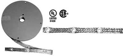

    [​IMG]If you're not into making your own, you might want to look at the various styles of strapping braid made by Electric Motion. That's their EM2080 product in the photo. The braid is preassembled with grommets every three inches or so. A 25 foot roll is about $50 which sounds expensive, but you don't have to solder it. Simply a sheet metal screw and star washer is all you need to make a good bond.
