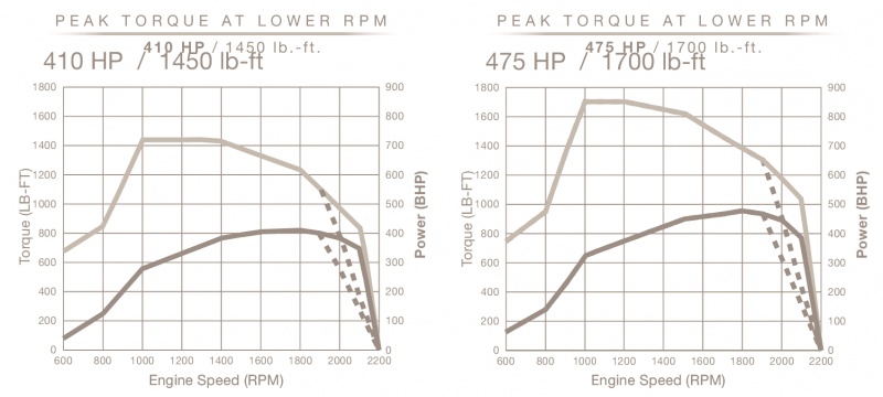

  8. double yellow
    double yellow Road Train Member
    5,946
    10,066
    Aug 28, 2011
    State of Jefferson
    Could be a 13, but probably a Maxxforce 11:
    Still a low rpm engine. If you can maintain speed in top gear, that's where you should be. You may not be able to instantly accelerate, but you downshift when you need to accelerate. It is a manual transmission -- you will need to change gears.
