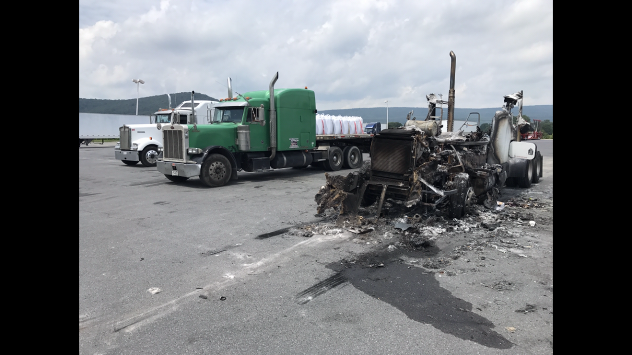

    What's the asking price? A little paint and you're good to go.

    Does have some decent drives lol,

    Jeez. And I thought I like me a little scrapper... You two are predatory for that burnt iron LOL. Those rears would be good salvage wouldnt it?

    The Craigslist ad almost writes itself.
    "This truck is HOT! Must see. By appointment only (in pitch dark night...
    from the rear)".
