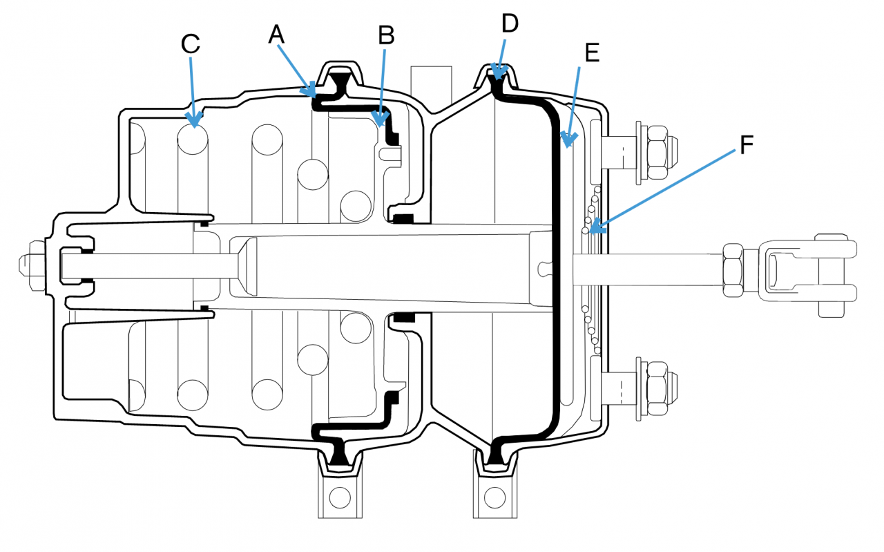

    Here is a diagram.
    B: Emergency diaphragm
    D: Service brake diaphragm
    The most common air chamber size on drives and trailers is the 30/30, which the spring brake diaphragm is 30 square inches and the service brake diaphragm is 30 inches.
    Basically the PSI you first start to feel your spring brakes come on is the max spring brake application pressure equivalent on the service brake side.
    Being either afraid to pull that knob, or pulling it too late will end in disaster. If you are moving down hill let's say and you lose your brakes, if you accelerate to a speed that relatively light braking won't stop you, neither will your spring brakes.
    Don't believe the tall tails about people being violently thrown by pulling the yellow knob. When you are light you may flat spot your tires, but when loaded it will be a fairly gradual stop.
