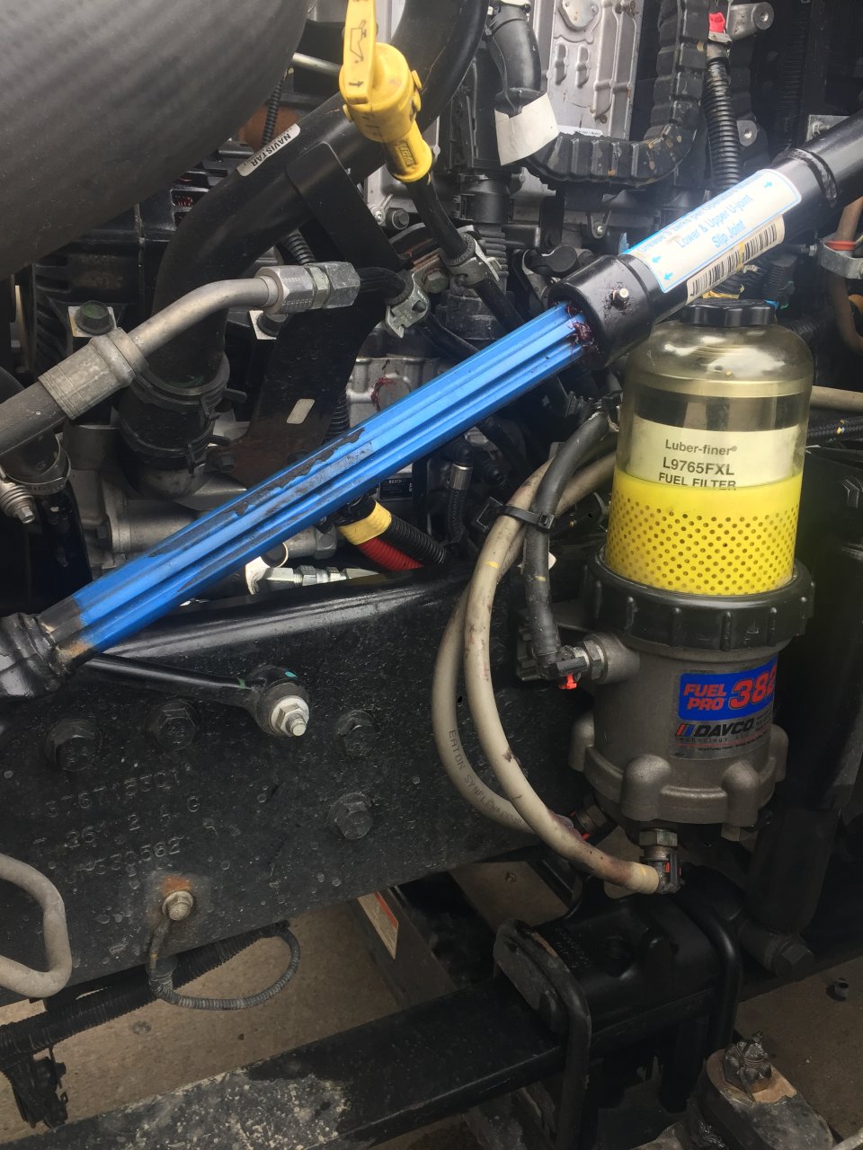

    They should have the bypass system on today or maybe early tomorrow. The tire shop I use in town had 4 brand new virgin XOne XDN2s and I went ahead and bought them at only 200.00 a piece. MHC had them taken off a truck they converted to duals. I’m good on drive tires for the life of the truck at a fraction of the cost now.

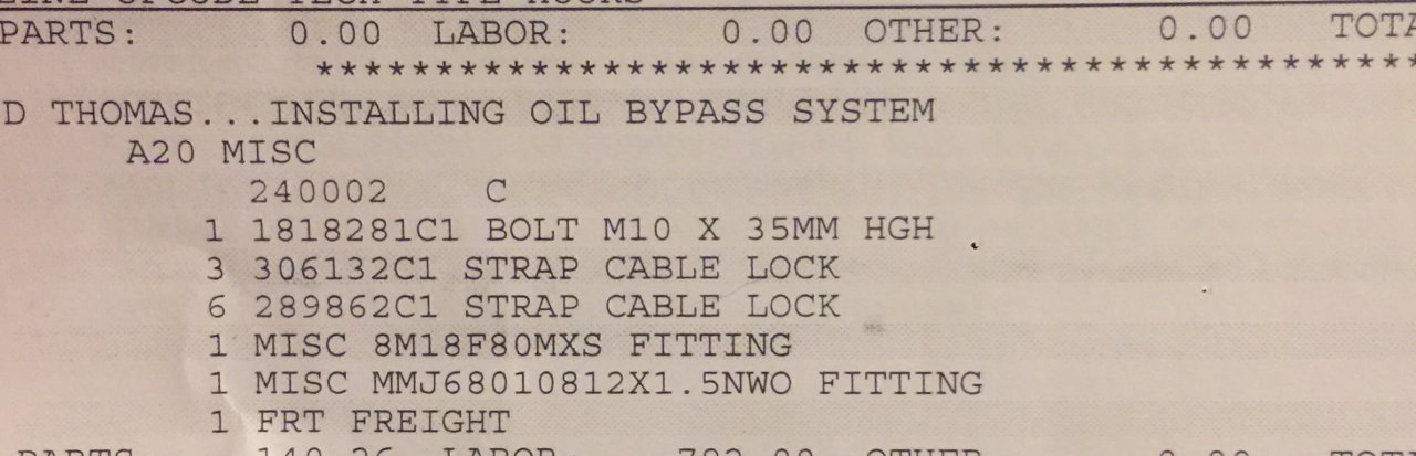

    I’m going to get a part list they used for the bypass and post that in the A26 thread for anybody else that wants to do it. They were able to use a port on the dipstick for the return and a port near the fuel pump for a supply.

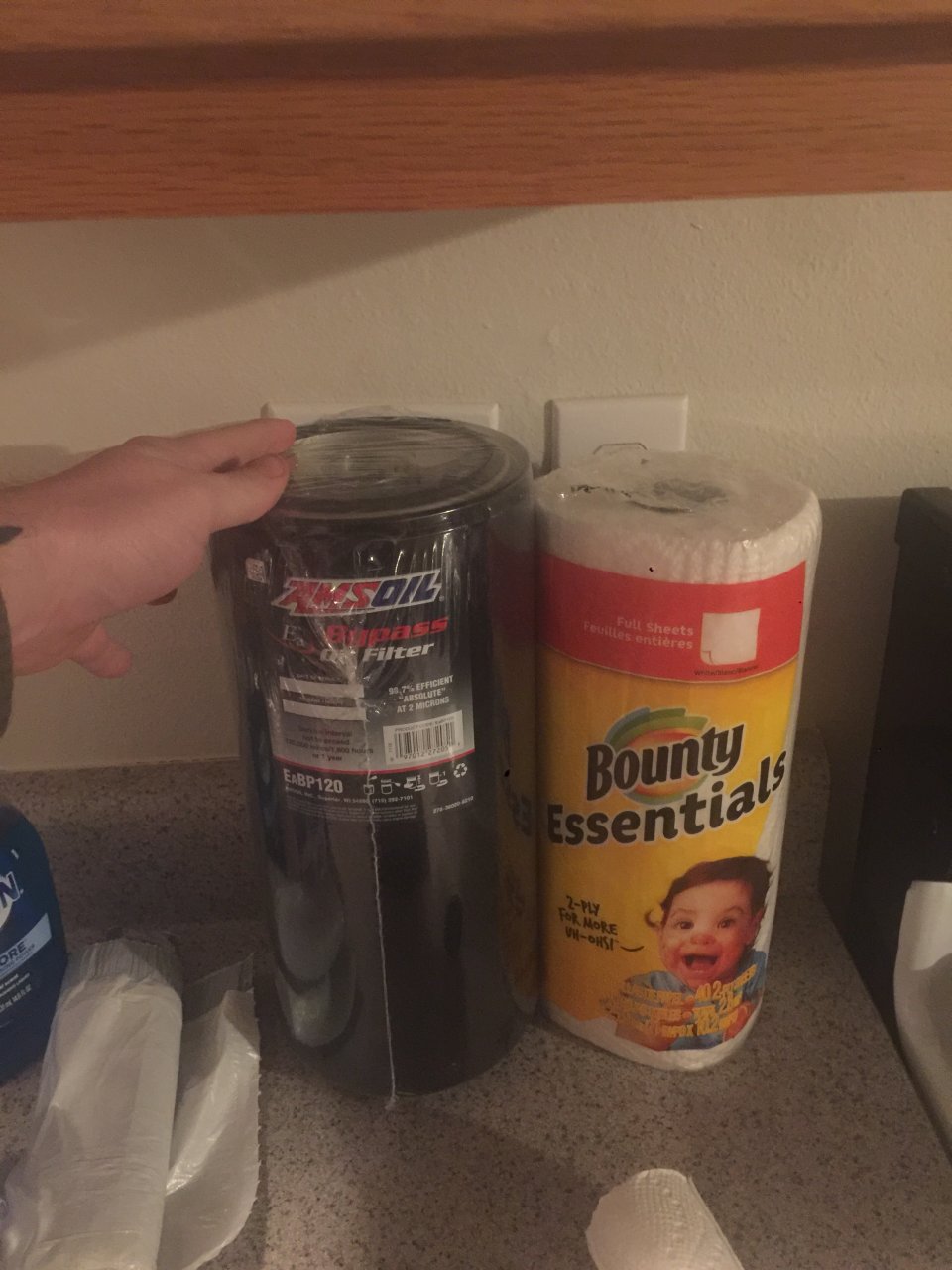

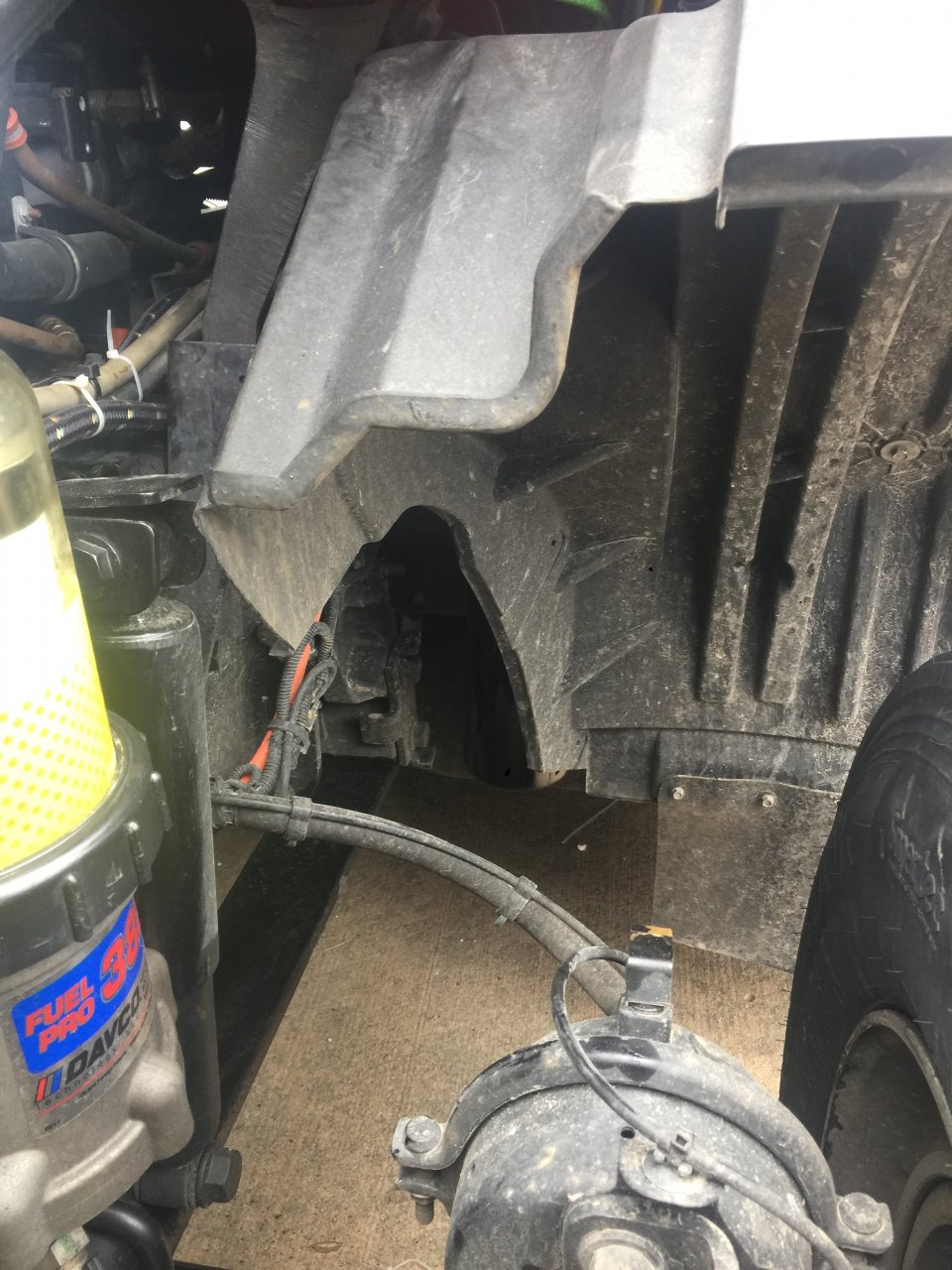

    Bypass filter is complete. If anyone has an A26 and you want the Amsoil Heavy Duty system on it; they ran the supply from a T at the fuel pump and ran the return to a port at the base of the dipstick. The filter is mounted on the batter box behind the driver side front fender. I’ll include the fitting list below, they used Stratoflex fittings.
    Im leaving tomorrow finally. I’m excited to see how it does when I get some miles on it. I test drive it today up to operating temp to make sure there were no leaks. Oil is black as usual but clear and you can read the hashes and letters on the dipstick. It’s usually opaque and black. The filter holds a gallon of oil so you’re increasing oil capacity by a gallon as well. The filter has an 1800 hour service life or 120k miles, whichever comes first.
