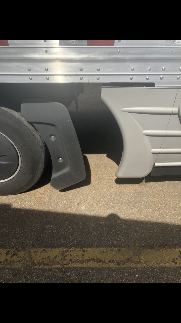

    Sure do. Can’t beat disc brakes. A skirt, especially the one I’m working on, could reduce air flow, I suppose. I would need to know how much airflow is restricted and how effective is air at cooling brakes in the first place. A lot of that talk around airflow and brakes only seems to be peddled by people that have something to combat this supposed problem. If you’re running a regular ol’ cast iron drum, I could see it, anything else, I’m not so sure it’s that much of a problem.
    If you must have drums, there’s a lot of options now. I would never run a regular cast iron drum brake again.

    I drove in rain most of the day today and noticed much less road spray from the truck to the trailer. The new skirt extends beyond the landing gear and makes a close gap between the FlowBelow. The old trailer had a standard length that stopped behind the landing gear. Road spray spreading outward then along the skirt shows air disturbance and drag. This new one has none except when I’d change lanes and am no longer straight or rounding a curve.
    I’ll have a good fill to test once I head back to the Midwest. I filled up in TN on my way to VA then I pickup in PA to MN.
